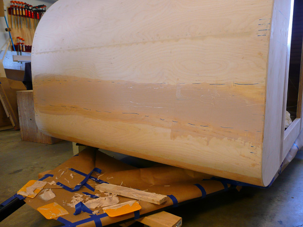

Postby aggie79 » Mon Aug 06, 2012 9:41 am
I used good 1/8" (actually 3mm) Russian birch plywood. It took some effort, but I was able to apply it to a 6" radius at the lower front of our teardrop and a 10" radius at the hatch without needing to wet the plywood or pre-bend it.
(In the above picture, I had applied some epoxy fairing mix to the seam between sheets of plywood. At this point I had not sanded the excess fairing mix.)
The plywood was plenty strong by itself, but after the aluminum skin was installed it easily can take my 200+ pound weight crawling around on the roof.
