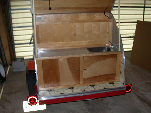

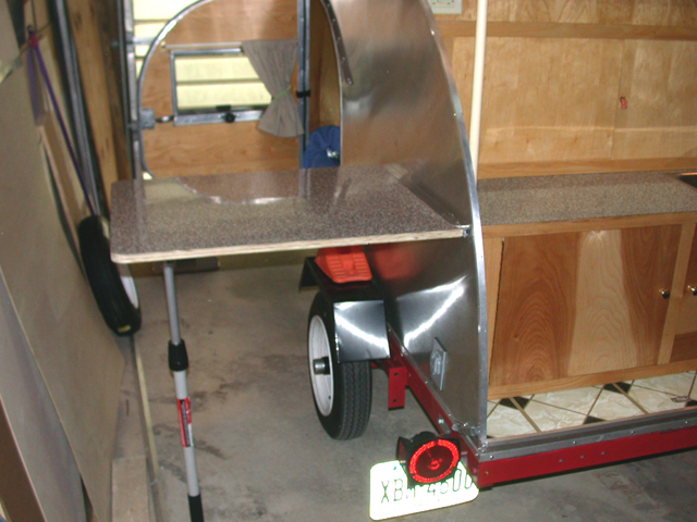

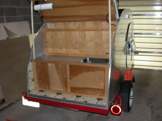

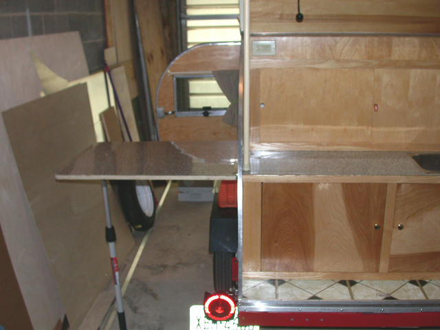

I don' think that I have the ideal galley, but this is what it looks like. It is in a 4x8 Cubby. The Side table is used for the cookstove. It gives us alot of extra space and gets the cooking grease out from under the hatch. Just sliding doors in the upper cabinets and two swinging doors on the bottom. And yes, before anyone ask, I know that the patterns are opposite to each other on the bottom doors. (I didn't notice until they were already half done and I did not have more birch on hand)

Postby angib » Fri Oct 07, 2005 4:15 pm
Kerry,
Nice work. How is that table attached and what is the telescopic leg made from?
Andrew

Postby jim7310 » Fri Oct 07, 2005 4:18 pm
Kerry,
Also, where do you store the table when packed up?

Postby toypusher » Fri Oct 07, 2005 4:32 pm
angib wrote:Kerry,
Andrew
With a bracket that I got from an RV dealer. Actually the idea came from pateardropper on this board. One part fastens to the tear and the other to the table. The leg is a paint pole that I got at Home Depot
jim7310 wrote:Kerry,
Jim
I just take it off and put it inside the cabin on top of the mattress. The table is 24 x 30 inches BTW.

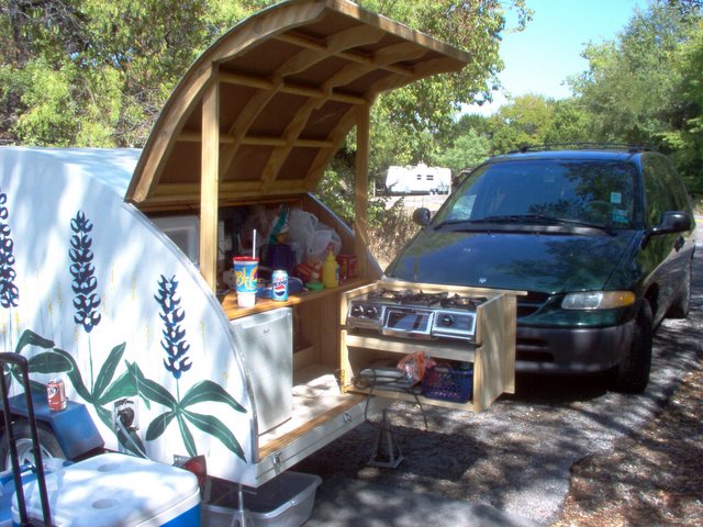

Postby davel » Mon Oct 10, 2005 8:06 am
Our galley is gradually coming together. It gets more useable and comfortable every campout. The latest addition which is far from finished is the swingout stove.

Postby TomS » Mon Oct 10, 2005 8:48 am
davel wrote:Our galley is gradually coming together. It gets more useable and comfortable every campout. The latest addition which is far from finished is the swingout stove
Nice! What a creative way to maximize your counter space.

I kind of like it that way. I've gone from not knowing what birch was to really liking all the different patterns of the grains. I purposely picked pieces that had the most variations it whenever I could to give it character.
P.S. It kind of looks like a "K". Every artist should sign their work. ;)
