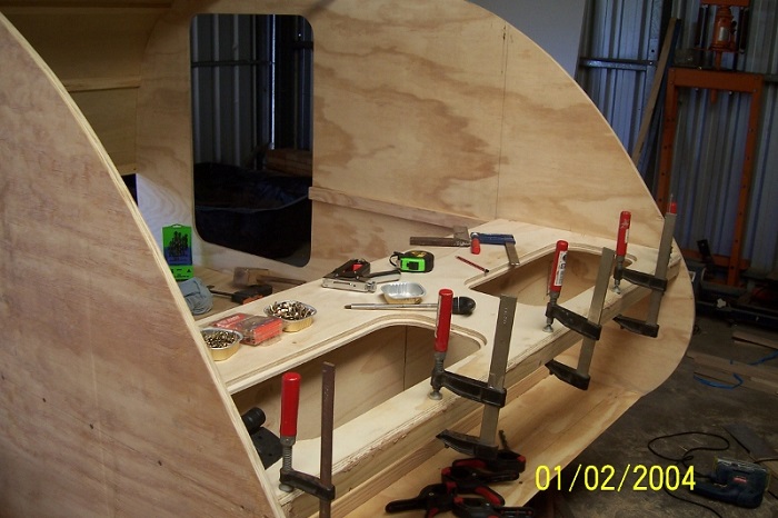

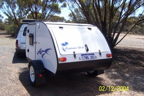

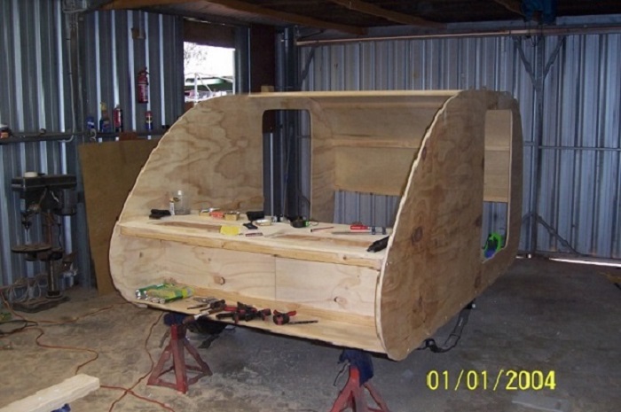

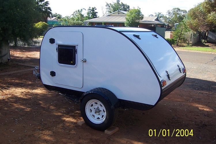

As I recall we used 15mm ply on the sides. 12mm on the floor and laminated 2X 3mm on the roof.
The whole shebang was then covered with steel sign sheet and ally checker plate on the bottom sides front and rear. The finish is the steel painted as supplied.
The number one picture was the first time out of the shed semi complete. The interior still had to done, doors sorted, decals applied and a few handles and such like fitted.
We are happy with it.
Take it easy.
RD
The camera date is out by quite a number of years. The Tear is about 18 months old. I gotta admit I am a bit slack when it comes to that sort of thing.

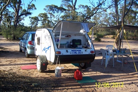

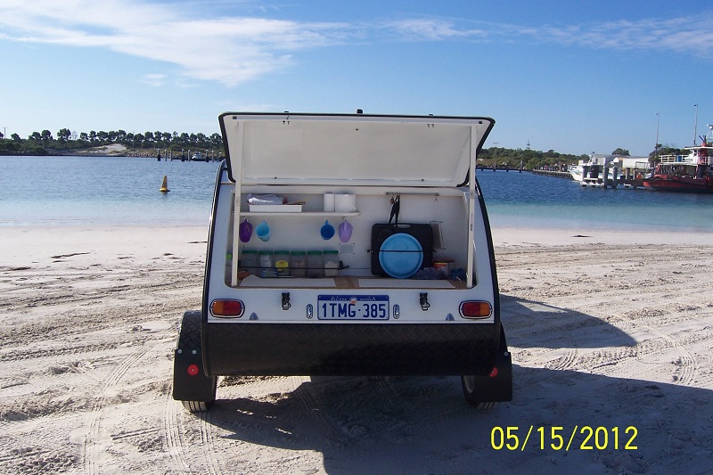

Postby Roo Dog » Tue Mar 26, 2013 9:03 am
Rob,
The hatch is made up of one inch ally box section with ally sheet welded to the frame. This has a sheet of steel bonded over the top of the ally sheet. It is a bit over engineered.
The hinges are common plastic garden gate from the local hardware.
Stowage is under the galley deck.
Still working on collapsible stays.
