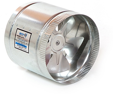

  • With the 110vac, 240cfm, 266 degree max temp, 6" diameter inline duct fan due in on Friday, I can rework the ducting and finish the HHRv on Saturday.
    axial inside-the-duct fan; my hope for a solution
  • 2bits Since I have no way of routing the exhaust downward from its location, nor upward due to the hatch to roof water shield, my choice is to stick with the current routing, and force the hot air out faster (if need to, I'll eliminate the inner rainshield entirely, and put a drain in the exhaust tubing, in the offhand chance that it'll collect there, since I'll route the tube downward towards the vent, if possible).

Postby working on it » Sun Jun 02, 2013 9:53 am
Received my Aero-Flow 6" booster fan yesterday; impressed by it's quality look and feel (made in Indiana-USA, I believe). Detailed instructions (in English!), template, mounting hardware, packaged well...and delivered to my door by UPS (shippers choice, my preference!). I almost don't want to install it because it's so perfect...much different than many of my E-bay purchases. Normally, I shop locally to see what I'm getting in person, and picking one that is undamaged and complete, and not receiving something in pieces with the box opened or crushed and with parts missing. Refreshing experience!

  • Wired in the duct fan and re-configured the ducting. Tested in 84 degree garage by running at 75% setting for 2.5 hours. Result: success! The A/C output was a 40 degree breeze, taking the interior temperature of the trailer to 58 degrees. The exhaust temperature, as measured with the temp gauge stuck in the vent (reading the metal temp, not the air temp) reached 160 degrees and stayed there as long as the compressor was running, when it would cycle off (as designed, not as a failsafe measure), the exhaust vent temperature would rapidly fall to slightly above ambient (due to the A/C fan still blowing in conjunction with the booster fan...the holes in the rainshield were helping too). Boy am I glad it is working right; I didn't want to start over with a different A/C set-up. Here's coupla pictures of the final configuration
