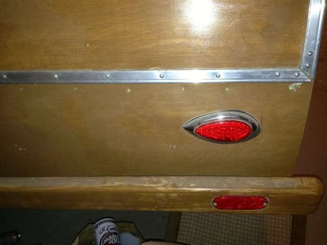

Mine is largely decorative, but does provide a bit of protection, as well.
Ot's simply a nice 2x4 that I sanded, stained, etc. it is mounted with custom stainless steel brackets (not visible in photo).
I finished it off by insetting reflectors into it.
--- sorry the photo's not great. Little Tow is tucked deep into the garage and that's the best pic I could get where it is now. ---

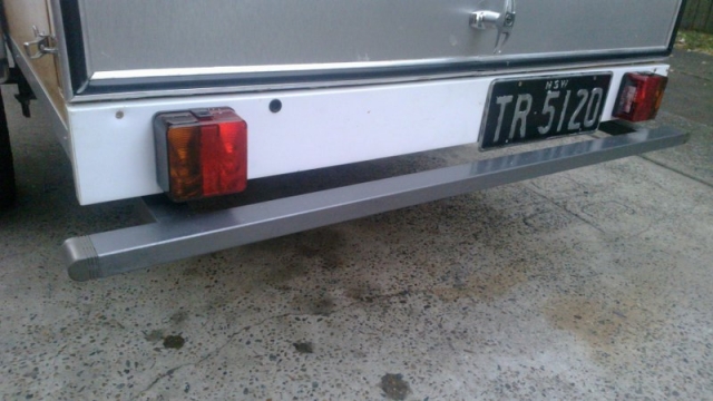

Postby michaelrsydney » Sun Dec 29, 2013 6:16 am
My rear bumper is to protect the otherwise vulnerable tail lights. It would also act as a skid rail over rough terrain. The steel was recycled from a found white board stand complete with plastic end plugs.

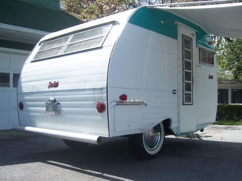

Postby len19070 » Sun Dec 29, 2013 12:03 pm
I've put them on a few Trailers, but mostly for looks.
Made from an RV awning tube.
