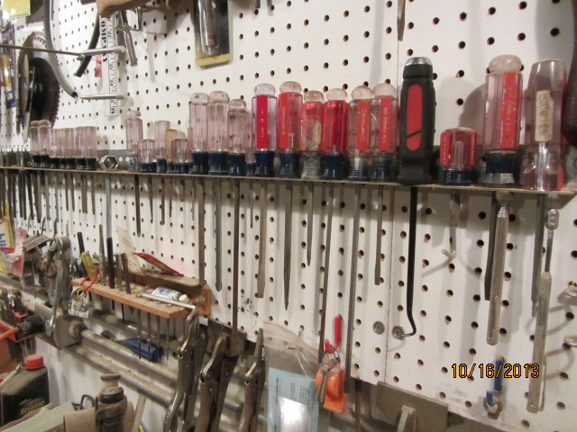

I used some slotted angle left over from hanging my garage doors to hold my screwdrivers, spade bits, etc.

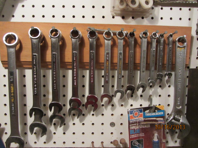

and some baseboard with nails in it to hang my box-end wrenches from

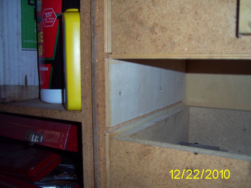

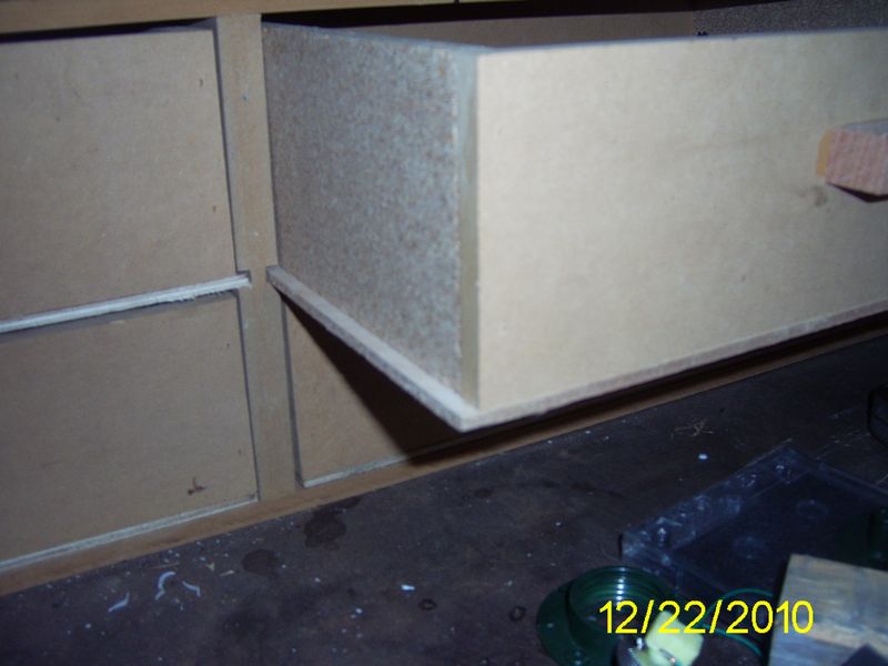

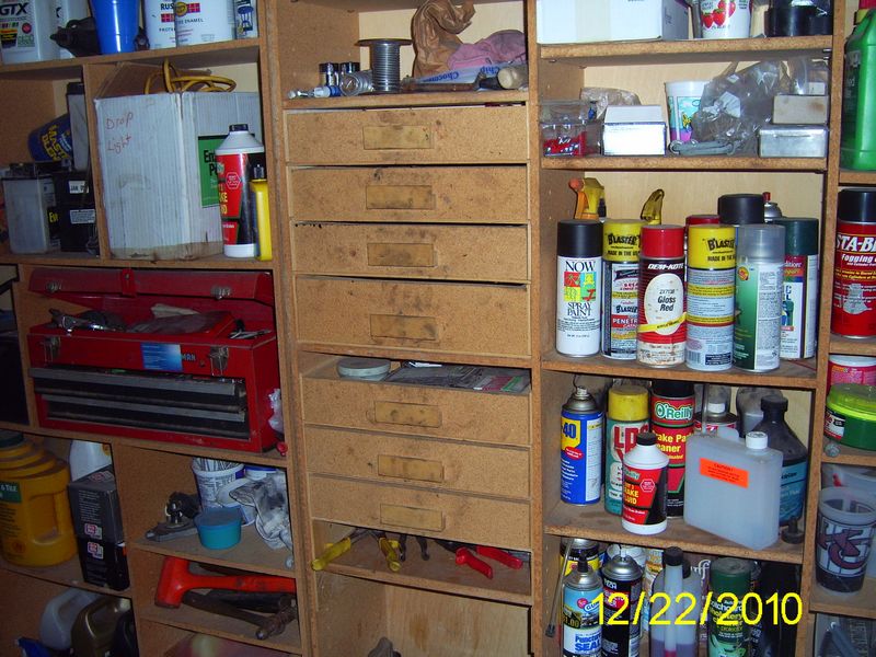

Easy drawers to make,without slides...

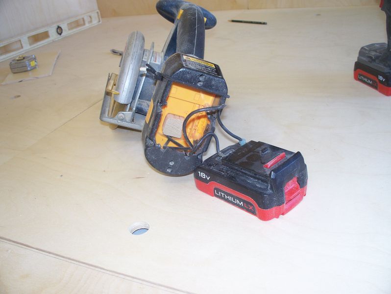

I got tired of those Ryobi batteries not lasting and the drills were giving up so I got a porter cable drill at a pawn shop.... But some of my Ryobi tools are still good...So I gutted an old battery and adapted it...
