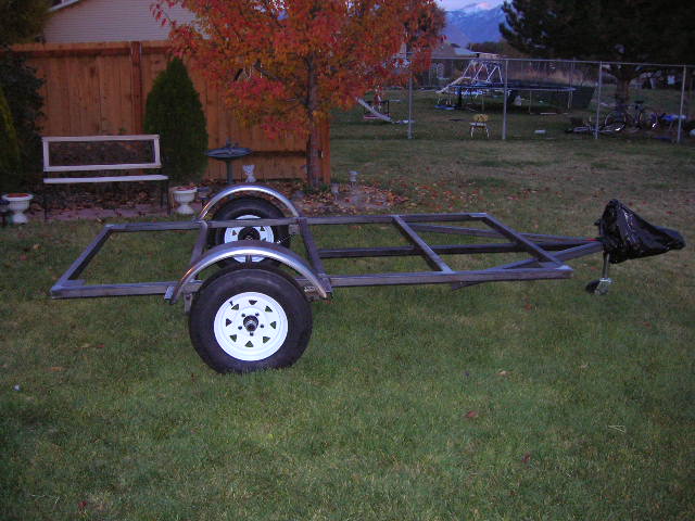

Postby sunny16 » Mon Nov 07, 2005 10:55 am
Got the fenders welded on over the weekend so now its ready for the paint. Just wanted to post a picture or two.

Postby Joanne » Mon Nov 07, 2005 12:09 pm
sunny16 wrote:Got the fenders welded on over the weekend so now its ready for the paint. Just wanted to post a picture or two.
Sunny,
Thanks for the pic. We all love to see them. That's a good looking trailer!

Postby sunny16 » Mon Nov 07, 2005 12:21 pm
Here is "the rest of the story". I can't figure out how to add multiple pictures. So here is the whole frame side view. I'm pretty proud of it since it is my first attempt at welding. It turned out pretty nice, if I do say so. Thanks again for all the input and info from this forum. Lots of great information and TT building ideas.

Postby sunny16 » Tue Nov 08, 2005 10:25 am
Well, I took half day off from work and prep'd and painted the trailer frame. I used the Rustoleum Black Hammered paint in a quart and sprayed it on. My sprayer didn't like it too much but I didn't thin it down. You need a special thinner as specified on the can. But the sprayer did work ok and the Hammered look is pretty neat. It especially shows well on the fenders. It a pretty neat paint and it didn't take long to dry. Just watch overspray as it seems to leave a dust on already painted surfaces. But it's pretty cool paint. Thanks for the advice on this thread. I would suggest getting a spray can of the stuff just for touch up in case you miss an area. I will do that later. So now its on to the design and to start building the body. I did take the trailer out and pulled it around the block to see how it tracked. Looks great! It will even look better when it has the body on. Hopefully by next spring or summer. 8)
