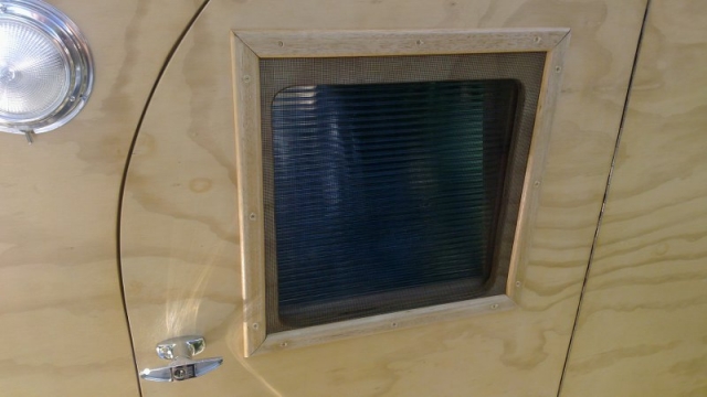

I fitted fly screens to the outside of my Wiley windows yesterday and realised I should have thought a little more first! The screens I fitted are simply fastened to the outer surface of the door with brass screws and will work fine, but I "next time" I will do them differently.
First, it would have been better to fasten the screen frames using cleats and toggles to make them easily removable.
Better still, with a bit better planning I would have made the inner parts of the window able to accept a cassette style of screen. To do this the slot into which the glazing drops would need to be deeper to allow the screen to be dropped in first and sandwiched between the glass and inner face of the door. Does that make sense or should I draw it?
No problems, maybe I will modify the ones I have down the track. In the mean time my TD is mozzie proof :D

Re: cheapest windows possible, the Wiley Window
Postby rowerwet » Sat Dec 14, 2013 8:16 am
do you have a way for any water to drain out of the window chanel?

Postby michaelrsydney » Sat Dec 14, 2013 7:58 pm
rowerwet wrote:do you have a way for any water to drain out of the window channel?
Not clear in that latest pic, but the bottom section of the window aperture is open... no outer lip. The screen is flush with the bottom of the cut-out and so water drains out through the mesh.
If you look at my earlier post you will see a pic of the outside of the window before I fixed the screen. The lower gutter is high on the inner edge and open on the outer.
