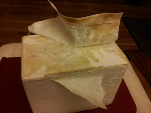

The Titebond III test is underway, and after 4hrs, I think it's the best choice. It has not bled through the Tyvek as the PU glue did, and it was very easy to clean up the excess with a damp rag. Adhesion seems to be very good too, although I can tell that it's not fully cured & dry because the Tyvek surface is still cool to the touch from the water vapor passing through the Tyvek and then evaporating.

Postby Bob Hammond » Sat Oct 12, 2013 5:14 am
KCs-
Since this was a small scale test, I just smeared the glue over with a stiff notecard, but if I were going bigger then I'd use a roller too.
Here's the pic of the Titebond III tear-off test. The result was better than the PU, I think. The glue adhered very well to the Tyvek (the Tyvek delaminated upon tear-off), and it bonded very well mechanically to the styrofoam. I think that the application technique had some effect on this. I applied a medium/generous coat on the stryrofoam and spread it around, and then applied the Tyvek and pulled it back to see that there was an even coat on it as well. Then I laid it on again and rubbed it down smooth. I think this action forced the glue into the surface crevices of the styrofoam. I was very happy with the easy cleanup, and that the glue did not bleed through and discolor the Tyvek's outer surface.
There is something else that i noticed that might become an issue on a large scale glue-up: the Tyvek had a tendency to creep at first because the glue film acted as a lubricant until it started to develop a tack. On a sloped or vertical surface, I'm concerned that might become a problem. But maybe not, or it might be necessary to put on some thumbtacks or other mechanical fastener until the glue goes off.
I think it's time to do a larger test assembly, and leave it outside in the weather for a month or so. I might also do some joining tests of the 2" thick styrofoam panel. I'll use the Titebond III in a simple butt-joint, and make another with a reinforcing spline of 1/4" or 1/8" plywood that is embedded about 1.5 - 2" into the edges of the styrofoam (as soon as I think about how to make the slot - on table saw?).
