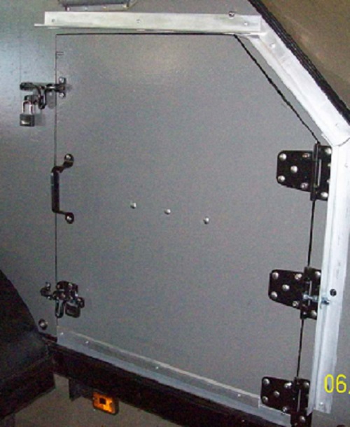

As a simplistic, but practical, way of matching door shape to unorthodox profile, I cut mine out of a sheet of plywood. My regret about this action was doing 2 sides at a time,1.5" thick, with a spiral saw (my bad luck with jigsaws is well-documented). The cutout left a rough edge, which I smoothed and enlarged to allow for the automotive seal. Another regret: I laid one door down flat, but the other was left leaning against a wall for three months, before I sealed them. There was slight warpage on the standing door. None since sealing and installing them.
doug hodder wrote:...the door styles for a pre-made one may not fit with the overall appearance of your build.... Build in some allowance for a D seal, don't make it an afterthought. Think it all through, like Grant said, it's not all that tough. I've done 8 solid doors with no warping afterwards so it can be done.
Like Doug said, and Grant too. It can be done. Mine are not like most others'...they match the profile, are solid, have no windows, have excessively strong (and stable) hinges for their weight, and use two door locks to spread the load. They are sealed from the weather by two coats of poly inside, three out, and have two coats of acrylic enamel on each side as well. If they warp, it's not because I overlooked something. I'll use metal next time!

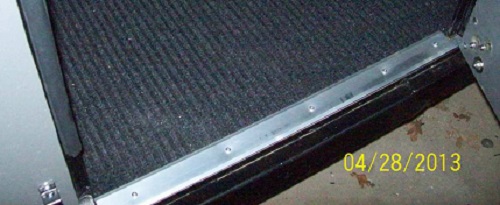

I installed 1/8" aluminum strikers and a curb to attach another seal at the bottom by the mattress.
I put another striker plate near the top of the door.
Also a full length piece of 1/8" x 1 1/2" aluminum over the inside part of the "Grant piano hinge".
This gave me a place to apply a 5/16" seal to face the back side of the hinge where it closes together.
I used the same screw holes and it's hardly noticeable from before.

Postby working on it » Sat Oct 19, 2013 11:44 am
You guys are craftsmen, and quality driven; I'm a shadetree mechanic looking to make my own innovations, just to see what'll work and not, function not form. In defense of my solid one-piece doors: If you spread the loads caused by the act of closing/sealing the doors, and waterproof them, then future problems should be nil. Though my cut-out doors are of non-standard shape, I endeavored to spread the loads/forces involved for a tight, even seal all around. I spent some time figuring the most well-distributed loading points before I added the hinges. I did the same figuring the optimal placement for the dual-locks.
I used three heavy duty gate hinges with nylon bushings, and bolted them on. There will be no sag, considering the light weight of the doors. The slide-locks were chosen for security and to further spread the load. Sealed high and low, the doors are held firmly against the routed interior framework and automotive door-seal.
I keep them tightly shut at all times; can't warp if they're held flat! Another consideration for the door seal, was that I didn't want to have a raised ledge under the door to crawl over, or to compromise sitting there. I made the doors to sit flush on the floor surface. To seal them from water incursion (or air drafts), I sanded off just enough material on the door bottom to slide over a door threshold (friction-fit); then I added a door sweep on the outside, to block and direct away water and wind entry.
(Note: the incomplete doorseal in this photo is a scrap used for adjustment/fitting). Lastly, I made my own rain deflectors to block wind-or-highway speed-driven water. The squared angles should also deter surface tension of the water causing "wicking" into the door seals. Like I said at the beginning of this post, I tried things that others may not...I'll report long-term results, good or bad!

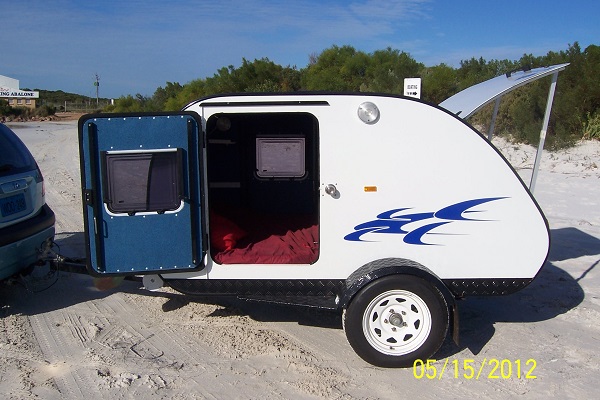

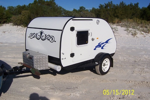

Postby Roo Dog » Mon Oct 21, 2013 6:22 pm
WOI,
Self made for us. We started this build with little knowledge of what was available.
Doors are a lamination of ply, ally sheet and steel sheet.
In hindsight we possibly would have done things differently.
RD :)

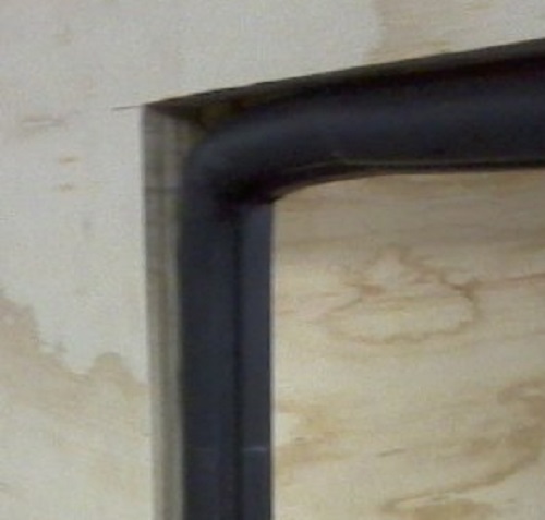

Roo Dog- I see how you sealed your doors (I enlarged the pictures; looks like a surface seal on the trailer side?), but I was referring to the Trekker video.
173193172890148599

Postby Roo Dog » Mon Oct 21, 2013 7:19 pm
WOI,
Flat seal on the door, contacts the body surface and a P seal on the body which sits between the door and the body.
Door hinges are plastic garden gate variety spaced out from the body so the door seal contacts the body flat with no seal slide across the body face.
The two vertical sections of 1 inch box are very slightly bowed, apex of the bow at the central lock, which tensions the door when closed giving a very good seal. The 1 inch box looks bigger in the picture due to shadow.
We plan to remake the doors, same method but do a better job.
No leaks so far, two years old and had some heavy rain.
RD
