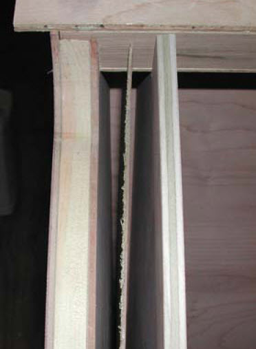

I have a question about your sandwich for the hatch cover edges.
In the photo above you do not show the 1/8" spacer that Steve Fredrick's Shop Manual talks about. I hope Steve doesn't get mad but I copied part of one of his pictures for this discussion. By the way, if you are building a teardrop for the first time I highly recommend buying Steve's Manual.
In this photo Steve shows an 1/8" spacer that I'm just not sure where it goes and if it's temporary or a permanent part of of the galley wall or the hatch.
Could you please comment on this? Did you use the spacer? If so, how did you use it?

The spacer is not added to the hatch, it's added to the galley portion of the wall and fits flush with the other layers of the wall. The next piece added to the galley wall–-on the inside––is the 1/2" thick piece that protrudes up from the wall and touches the rubber seal inside the hatch. Look on page 258 of Steve's manual.
That 1/8" spacer that's in the wall allows the 1/2" protruding lip (he calls it the inner galley) to fit into the center of the hatch's (3/4") groove with an 1/8" to spare on both sides. It works great.

I cut the sides of the hatch off of the almost-finished wall and set them aside. (It'd be a lot of extra work to lay them up separately and make them fit.) Then I glue in the 1/8" spacer in the galley wall. You can use a trim bit to make it flush with the rest of the wall. Once that's done, glue in the 1/2" interior galley piece (that sticks up about a half inch and will eventually touch the seal in the hatch). Now... if there are any voids where the 1/8" piece is––and there really shouldn't be––you could fill it with some glue/sawdust of epoxy or whatever your filler preference is.
Here's a wall that's almost ready to be attached to the floor:
On this little 4 x 8', I saves some weight by using with a 3" lip of 1/2" ply but it was a bit of a pain. But you can see the area that has the extra layer of 1/8" that is the spacer (the lighter colored wood on the right wall).
Here's another look at one of those walls:
I don't know if this pic helps, but the 1/8" piece on the wall puts the half-inch lip right in the middle of the groove in the hatch when its closed. (You really can't see it in the wall pic, but it's there.)
Perhaps you can see the spacer here?
