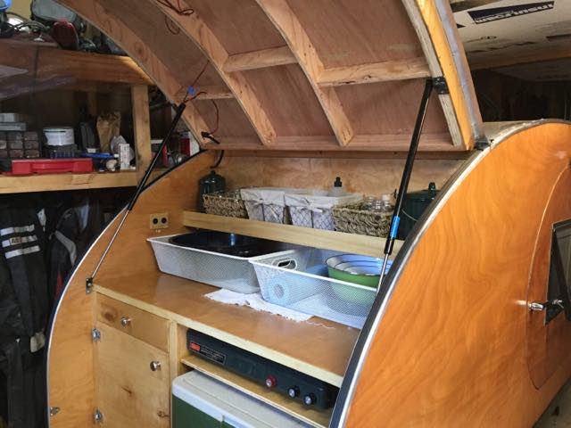

Dan-
Spot On!! Thanks for making the calculations, it worked perfect first time. Bought 50lb and 29" - Auto lifts by itself and shuts with around 5 lbs push.Feels the same as my SUV hatch. I would have wasted a bit of cash without your work. :applause:
galley3a small.jpg (121.97 KiB) Viewed 8674 times

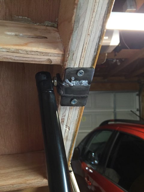

Postby Kanook » Mon Oct 19, 2015 1:32 pm
Worked perfect for me too. I went on the cheap. Spent about 30 min and $10 digging through a pile of new lift struts at a freight salvage/over goods store till I found two matching that fit the requirements and then used scrap metal I had and welded my own mounts.

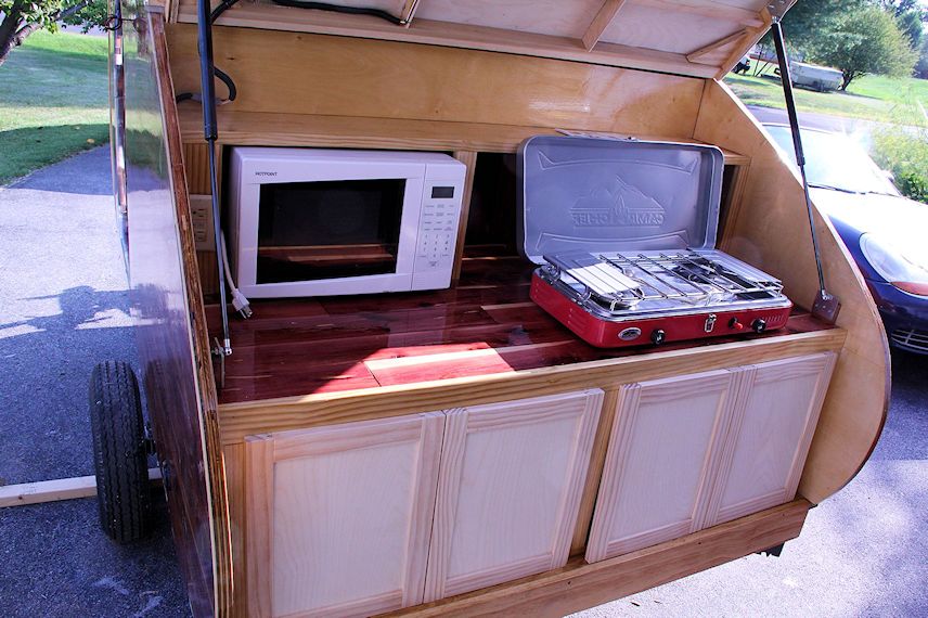

Postby Paradiseteardrop » Thu Nov 12, 2015 10:37 am
Hi I used the calculator for my Benroy hatch. It worked out to 80 LBS. LIFT IS PERFECT. After starting with 2- 40# I worked up in 10# stages and it ended up with 2- 80#. This was the figure I got in the first place. The lifts were in 10# stages at the RV store. Just round out the figures you get. 1.6123.-- 6 is over 5 so it can be a 2.000. Work out the figures shown a couple time then do with your figures.
Take care where you mount the bottom of the lift. 8-1/2 from the hinge pin. Lift the hatch to the height you want. Wacks on the forehead you do not want . Swing the bottom back to clear the hatch and mount.
Now to try and figure out how to load pictures here. This is my second one with FRP skin . Lee

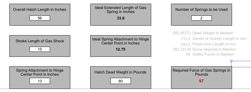

Postby Strop » Tue Dec 22, 2015 6:48 am
Hi all,
Just using the calculator, Dan thank you very much for this BTW :applause: :applause: , but I have a question.
a
After doing all the calculations I come out needing 97lb gas springs, that need to be 33.6 Inches long. Now my conversion for that is 430 Newtons and 853mm. The closest match I can find is 500N (112 lbs) and 830mm (32.7").
Screen Shot 2015-12-22 at 10.45.11 PM.png (40.2 KiB) Viewed 8369 times
Will 112 lb gas springs be too much? I can see that a safety margin of 50N has already been added in.
I can get struts that are 400N (90 lbs) that are 816mm (32.16") long.
Are they too small?
Thanks
Strop
Posts: 148
Images: 10
Joined: Wed May 15, 2013 3:12 pm
Location: Armidale, NSW, Australia

Postby danlott » Sat Jan 09, 2016 12:58 pm
Sorry I have not been online much in the last year. I am happy that this calculator has helped so many people.
Sometimes the ideal spring lengths and weights for your hatch may not be available. If this is the case then I would do the following.
1. Using the calculator, adjust the "Stroke Length of Gas Shock" of the springs that you locate that are as close as possible to the ideal length and weight of what the calculator suggested.
2. Then adjust the "Spring Attachment to Hinge Center Point in Inches" based on the "Ideal Spring Attachment to Hinge Center Point in Inches" calculation.
3. The new "Spring Attachment to Hinge Center Point in Inches" value will adjust the "Required Force of Gas Springs in Pounds" value.
Play around with these numbers and compare them to the various springs that you are able to locate. You should be able to come up with something close that will work.
Dan
