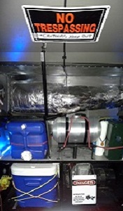

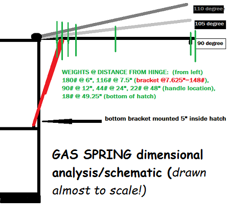

  • Computer back online! Project completed! It works!! I went with Plan 2b (Plan 1 was an electric linear actuator, Plan 2 was a single gas spring mounted off-center on the galley shelf, and Plan 3 was dual gas springs mounted next to the hatch prop rod mounts). I was not exactly sure of my first set of measurements, nor of how the gas springs actually would react to the extreme angle I was seeking to raise the hatch to, so though the calculators said that 120-130 lbs would work (it varied from one calculator to another, and since all calculated in metrics, I could've made more than one error), I went BIG and ordered two 150 lb rated springs. If I found that more force was needed for Plan 2 (single), then surely the two springs could be made to work in the outboard (Plan 3) position. If I guessed correctly, that 150 lbs was enough, if not slightly too much force for the off-center mount, then all was OK.
  • When I re-measured this morning, with "not-state-of-the-art" equipment, I noted them to report here, and proceeded (with great trepidation) to drill the mounting holes in the hatch (I had already mounted the shelf bracket, in the optimal position, as the only spot Plan 2 would work at!). After raising the hatch up to the stars (it seemed), I finally snapped the spring onto its mounts, and slowly started to close it. It closed with moderate hand force, as expected, until it was about 30% open. Wouldn't close any further. I figured that was due to using the curved bracket, that bent from the force of the spring (I thought the curved bracket would enable me to gain more lift/angle, but it wasn't to be).Then I used the standard ball mount, in the same spot I had tried to use the curved; better, but only closing to 15% open.
  • Did a frantic re-calculation (wow, did I screw this one up?) with my smartphone calculator, thinking that I needed to move the hatch bracket to my originally calculated spot, but using my latest set of measurements. I calculated 7.625 inches from the hinge. Angrily, fearfully, drilled the second set of holes (dadgum it!), and barely missing disabling my high-mounted tail light system, I bolted on the standard -heavy duty- bracket. Snapped the gas spring in place again, and voila!, success.
    finalized galley with hatch lift assist.jpg (30.29 KiB) Viewed 830 times
    GAS SPRING SCHEMATIC ANALYSIS.png (44.22 KiB) Viewed 830 times

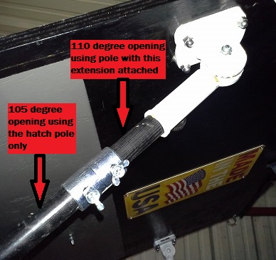

  • It works just like I wished, as an assist for lifting the heavy hatch high overhead (it is actually self-opening, up to 90 degrees, and floats there), holding it there while I attached the hatch prop rods, and lock them in place. I can easily install the extension for more angle (from 105 degrees to 110 degrees), if needed. The prop rods lock in place, to prevent wind from raising or lowering the hatch (no blow-over). Remove and stow the rods, use light hand pressure to close, and done. Hope my figures and experience will help someone else, especially a "vertical hatch trailer" builder, to install a gas spring assist on their trailer.

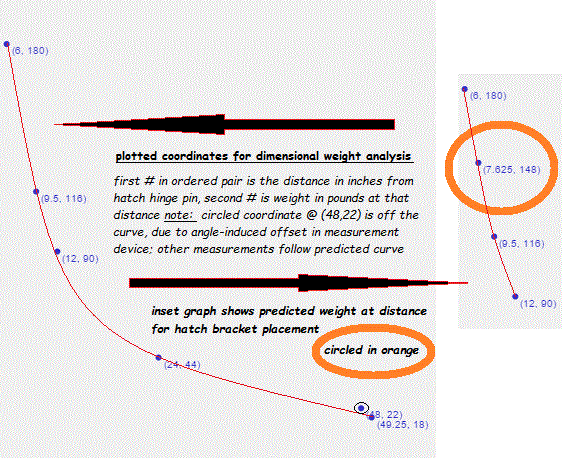

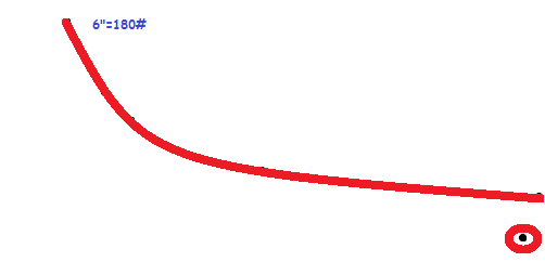

  • I was explaining to my wife how I arrived at the placement of the brackets, and how I used a graph to find the optimal equilibrium point, where the hatch self-opens to 90 degrees and floats there, while the prop rods are leisurely assembled and locked-in-place. After I bored her thoroughly, I decided to make a visual aid, and now I can bore you guys, too.
    preliminary rough graph, not linear scaled
    prettied up graph
    dimensional weight analysis graph- gas spring.gif (77.08 KiB) Viewed 816 times
  • As I was installing the gas spring, I started out just going by my memory, as I had left my detailed graphs/print-outs/plans for world domination on my desk at work, 60 miles away. Not to be delayed in my few hours of freedom per week, I endeavored to install the spring & brackets relying on previously marked points, but not quite sure which ones correlated to which device (spring or actuator) or Plan 1,2, or 3 (with derivatives). After the first and second hatch bracket spots failed, I used the calculator and somehow plotted a graph on a scrap of wood, and was greatly surprised that my impromptu geometry actually worked. Every dog has his day.
