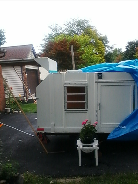

From my understanding of your explanation of when your hatch is open, there is a near vertical section of the hatch at the hurricane hinge and from this near vertical section your hatch extends back parallel to the ground. Is this is the case? Does rainwater run directly to the back/aft side of the hinge?
If so, I don't think the hurricane hinge is the "right tool for the job". The back side of the hinge is not designed to stop water flow.
Assuming this is the case, I would leave the hinge as is and add a rain gutter made out of lightweight aluminum channel about 1" aft of the hinge. This gutter would be open on both ends and would direct rainwater to the edges of your hatch and away from the hinge.
Re: Hurricane Hinge Leaks!
Postby Tomterrific » Wed Jul 08, 2015 10:15 am
Tom, good idea and good first name! :-) I do have a rain gutter made from aluminum siding J-channel over my doors. It works great. The hatch is as you described. I thought about using the J-channel over the hinge but when the hatch is down the gutter would build up water in a puddle between it and the hinge. I figured this could lead to a larger leak when the hatch is down.

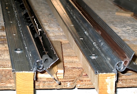

Tomterrific wrote:The photo does look backwards but the hinge is installed properly. The hinge is on a flat surface parallel to the ground. The open side is to the rear, closed side front.
I believe my best, possibly only alternative is a strip of rubber over the hinge, something I falsely believed the hurricane hinge would eliminate. I have the square back hatch cantilevered one foot. When the hatch is lifted it makes a roof one foot above the trailer. I can stand under this easily. With curtains/walls, this makes a nice area to change clothes. The back of the trailer is entirely open with a raised hatch so a motorcycle will fit inside.
Some crazy or clever ideas, you be the judge.
Heavy oil dribbled into the open side when the hatch is up. May eventually run out and fail. Horrible mess.
Hot wax melted into hinge. This does seem like it could work as the wax would fill the vacant area inside the hinge. Would the wax melt in the hot sun?
A grease nipple on one or both sides of the hinge. Once filled with grease water can't get through. Easy to wipe excess after filling. Easy to refill.
A rain fly! Merely a single sheet of cloth running from the open hatch over the trailer. A widthwise pocket sewn in the fly would fit over the bottom of the hatch, then pull the fly over to the front and tie it to the tongue. I like this! Not entirely my idea but very nice. I see a simple rain fly in my future.
Grease or oil is going to make a big mess and probably isn't going to solve your problem. I'd think that Grant's solution of a strip of rubber D-shaped seal on the rear of the hinge would help immensly, if not solve it complety.
Can you take a photo of your hatch in the open position? In close to the hinge and back off a few feet.
T
p.s. I just saw the photo of your open hatch. I'd still try the rubber seal on the rear of the hinge. It'd deflect any running water.
Postby ae6black » Wed Jul 08, 2015 3:56 pm
I have the same hinge as shown in your last pic. It leaks right through the middle,... simple fact. My answer was duct tape and tarp while being stored or stored in a garage. While out camping, nothing that can't be worked around. Nothing you did wrong. It's just that this style of hurricane Hinge just isn't what it's hipped up to be. End of discussion. Sorry to hear that you're having problems. If it's any consolation, you aren't alone.

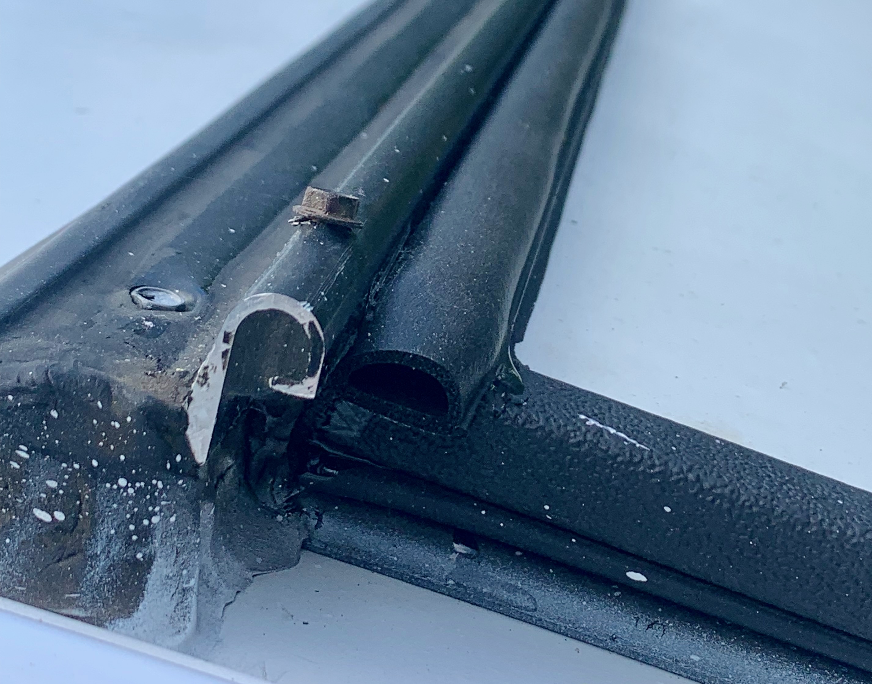

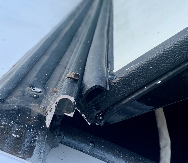

My teardrop's rear hatch leaks at the hurricane hinge, but only when the hatch is open. It looks like the water runs off the hatch towards the hinge. And it's not a tiny leak--it's a gusher.
I'm going to try the method mentioned above, as shown in this image:
I'm using the Taco Marine weather seal.
Fingers crossed.

Postby troubleScottie » Sat Jul 01, 2023 6:00 pm
Given the picture,
The left side of the hinge is a complete seal, one continuous piece of metal. As such it cannot leak. The only water inlet on the left side is the screw holes. A new hinge would likely have a 1 inch or so rubber strip fitting into that small channel on the left to prevent water reaching the screws.
The right side is a continuous piece to the hinge. The hinge is that metal piece crossing the center of the rest of the hinge. It is supposed to block the water and redirect out the ends of the hinge. That is the reason hinge extends over the edge of the trailer.
So why is it not doing that and you are getting a flood?
To me (not an expert), the hinge looks flattened. If it is not almost circular, so that center piece will not offer any barrier to water. The rounded edge at the inner most side could have broke or corroded. It appears you could side the hinge apart and examine it.
A rubber tube running the length of the hinge might help

Postby tony.latham » Mon Jul 03, 2023 5:06 pm
If you raise your hatch and put a garden hose up there, it'll leak like a river. His fix with the D-seal works fine.

Postby terrymorse » Mon Jul 10, 2023 10:47 am
terrymorse wrote:A google search brought me here, this place is a great resource.
Fingers crossed.
Update: The weather stripping method works! It's holding water out in both the closed and fully open positions.
The only trick was getting a smooth and flat surface to place the stripping onto. I removed the factory-installed hex head screws, counter sunk the holes, installed #10 stainless flat head screws, and sealed them with black roof flashing caulk.
