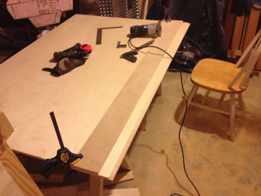

I am using 5x5 plywood on my camper build too. For the most part, we used a table saw to cut the sheets, but it took three people to control the cut on the little contractors saw.
Once the guy with the table saw left, I started using a straight edge (a cutoff from a 5x5 panel with a factory edge), and my circular saw. I know that my blade is 5" from the edge of the saw, so I would mark the line I wanted to cut, then mark a parallel line 5" away. Clamp down the straightedge down along the second line and make the cut, running the edge of the circular saw against the straightedge.
The same principal applies to routing the rabbets on my roof panels, seen here.
Note: i only used the chair to mark the lines! Never cut or route from a sitting position where the blade may pass over your body!
