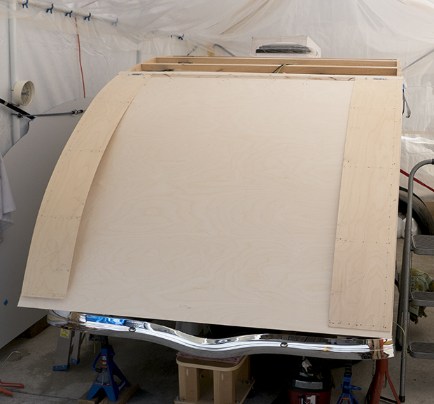

Postby RunnerDuck » Thu Sep 22, 2016 8:55 pm
TADA! :D
Good news everybody, I now have my galley hatch skinned with 1/8" plywood. After a couple of false starts like cutting the plywood the wrong direction, :oops: I put the hatch on the TD to make sure it fit perfectly and then put on the plywood.
I attached the plywood along the top with the temporary hinges and a few screws.
Hatch Skin 1.jpg (238.73 KiB) Viewed 692 times
Then I glued the edges and braces with lots of PL adhesive.

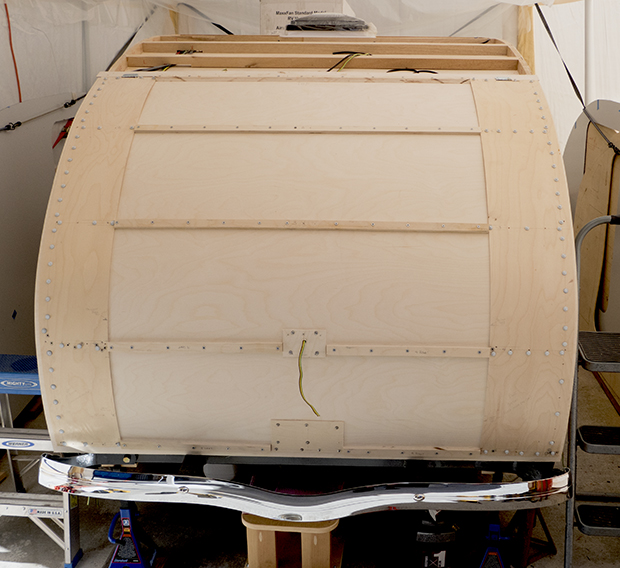

As suggested I clamped it all down with cauls and lots of screws. I let it cook over night.
Hatch Skin 2.jpg (266.42 KiB) Viewed 692 times
The next day I trimmed the edges with a router and by golly it fits perfectly :applause:
Now I'm ready to glue down the .032 aluminum skin on top of the plywood. I think I'll use contact cement and roll it in place.
Thanks to everyone for their comments and support. I really appreciate it and certainly saved the day.
Now to the side skins and the roof!

Postby Alan_H » Thu Sep 22, 2016 9:43 pm
Hooray!!! :applause:
Glad it worked out for you without having to start from scratch! :thumbsup:
Now it's time... as Stumpy Nubs would say... to sit back and have a cold one, 'cause you deserve it. :beer:
