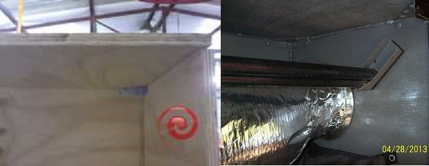

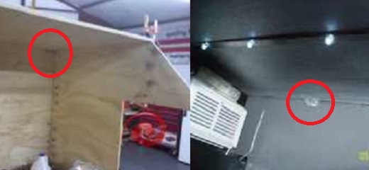

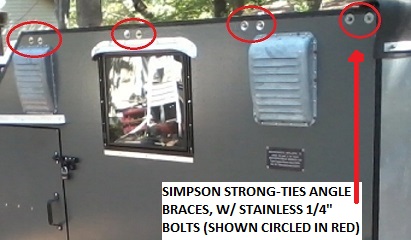

Postby working on it » Sat Nov 19, 2016 2:57 am
cabin roof bracing, no spars.jpg (29.37 KiB) Viewed 1295 times
yrock87 wrote:I don't know where the ply gets thick enough to skip the framing...To play devils advocate with you, why stop at 3/8 inch thickness? why not just make it 5/8...
Or 3/4". I used straight-cut flat 3/4" plywood on my un-insulated squareback TTT. Joined together with steel connectors in all stress points, glued with PL Premium adhesive in/out of every seam. I only used one sparlike wood brace, only on the forward 45 degree slope front of the trailer, as a precaution (unfounded worry) against wind-pressure. I used that spar to mount an overhead stereo/ventilation fan system anyway. On the roof, there are no supports, save for side bracing around the doors (also bracing the front slope and shelf), and steel corner braces for 90 degree joints, and Simpson Strong-ties gusseted angle braces around the perimeter of the roof (same system used on the floor, as well). The walls are mounted on top and within the outlines of the floor; the roof and front slope are laying on top of the walls. Four and a half years after the structure was completed, there has been no twisting or sagging of any part. Granted, the largest part of the roof is only about 1825 square inches, there is no sign of sagging nor pulling apart from the walls. However, I intend to retrofit a couple of internal beams to the underside of the roof plate, to fend off any future sags and add strength in order to add a roof rack, awning bases externally, and grab-handles inside (with a bad back, I have trouble rising up and out of the trailer!). I also plan to retrofit some insulation inside, to prevent minor wall-sweating, but not foam. Sorry about that, foamies (just kidding, to do it all over, I would've done it with foam-faced 1/2" plywood- w/1/8" luan interior walls).
  • 10284287424 front slope shelf, single spar/brace
  • 10280286964 1/2" oak screwed/glued to walls as doorframe & slope brace
  • 86957 roof plate mounted on top of walls with steel corner brace; later glue and angle braces
