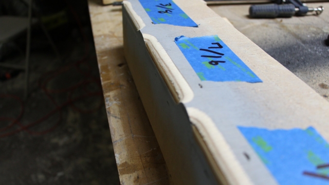

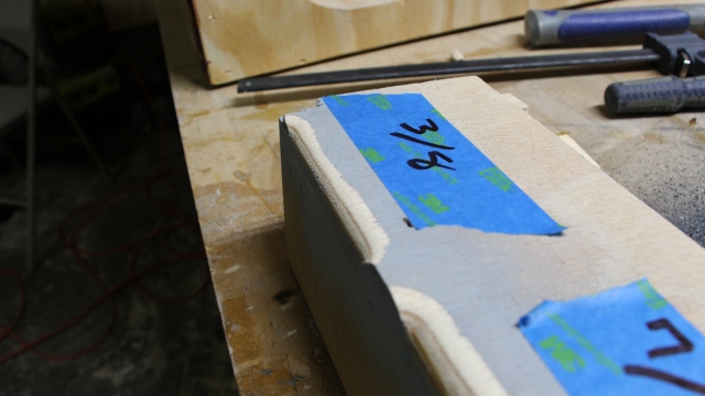

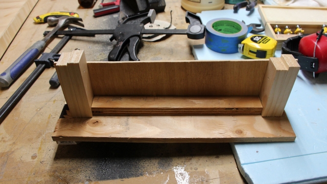

I did a mock up of my side wall/roof. Just in case someone else is interested in what a different radius might look like on the teardrop. I wanted to try out my larger round over bits.
I stapled it real quick so in one of the pictures you can see how the 1/4 roof is lifted off of the side wall. I don't think that would be an issue if everything was glued and secured properly.
Mock up of side wall/roof. I have the spars with the 3/4 blocking in between them. Then the 1/4 piece is the roof
Roof lifted a little on the 1/2 round over
What it would look like on the tongue box or side wall. Also If you look on my tongue box how close to the edge I put the staples. Hitting those with a larger round over bit might be an issue. Might want to watch staple placement in the future.
