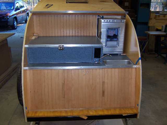

finished lower galley...new pics

c_mac wrote:MadJack - Is your battery box vented?
same question - is it ??
i´m planning vent it through floor maybe with little fan

yes it will be, there will be a plastic tray with an acid absorbing mat, a clam shell vent in the floor and vented out the top thru the AC exhaust hole

we did some more work...added some more photos...check out galley 3

The trailer is really looking good. I may try and come to Beavers Bend to check out the trailers. I'm afraid I won't be pulling mine as I won't be anywhere close to having it sealed up. Are you planning on taking this trailer with you?

...ubetcha buddy...it will be the grand unveiling of the Alligator Tear...I hope you can make it down...be sure and bring your camera :D

It’s very well done. :thumbsup:
You are almost finished and ready to go camping. :applause:

Raul...my partner Jim(B52 username) and I are pushing hard to get it finished in time for Beaver's Bend the end of March so that me and the missus can show it off

Jack, Lookin' good! The cam lock is very clever too.

MJ, What's with the funny looking toaster over you got there?

...why Rocky, that's not a toaster but rather a 24 can beer cooler...the whole trailer was designed just for it...ain't it cute :D :lol: ;)
