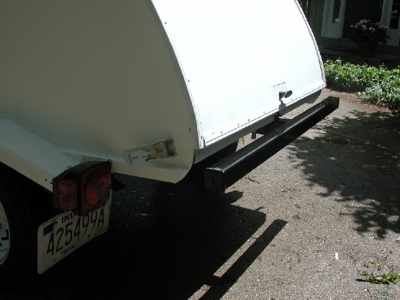

Cracker, just catching up on postings and saw your thread from last week. Just a thought but I welded on hitch receiver (about $20 from TSC) on the back end of mine as I wanted to use my bike rack while traveling. I then got thinking about bumpers for when I don't have the bikes and made a simple one with a couple pieces of 2" tubing. Worked great, wouldn't take a big hit but would fend off a small bump better than the wood hatch.

Postby madjack » Fri Feb 10, 2006 5:30 pm
brickz wrote:Cracker, just catching up on postings and saw your thread from last week. Just a thought but I welded on hitch receiver (about $20 from TSC) on the back end of mine as I wanted to use my bike rack while traveling. I then got thinking about bumpers for when I don't have the bikes and made a simple one with a couple pieces of 2" tubing. Worked great, wouldn't take a big hit but would fend off a small bump better than the wood hatch.
Brickz
Brickz, ya know I can't let a post like that go without asking...wher'z da pic...we wanna see it too :D ;)

Postby brickz » Sat Feb 11, 2006 6:02 pm
Don't want to hijack the thread but Madjack wanted to see pics so here they are. Hard to see receiver on the end of the frame before I started as it's welded right on the main tube running length of trailer. Other pic shows bumper in the hitch recvr. Last pic is with two bikes hanging off the back of the tear.
