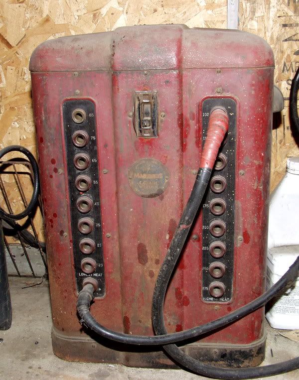

My ancient Marquette stick works as well as a fancy new one...at least for the type of general repair welding I do.
Not very pretty, but it's paid for!

48Rob wrote:I suppose one of each would be nice, but they sure don't give 'em away! :(
I think I saw one of those in an antique store... It was more expensive than a new one...... :lol:

Postby 48Rob » Sat Feb 04, 2006 6:44 pm
Gosh!
You know, it could be worth a lot of money :thinking:
I gave $50 for it 20 years ago...hmmm probably go at least ten bucks on Antiques Roadshow :rofl2: :rofl2:
