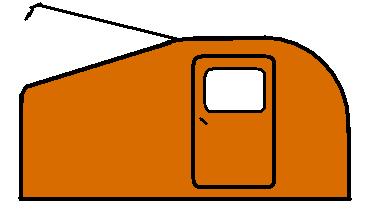

I was thinking about profiles too...
This would allow for a galley with taller base cabs then normal. No upper cabs, the forward part of the hatch would be open to the cabin.
However, I still like the Benroy, but might end up with a Rimple, as you suggested.
I just took some measurements - I would need an 18’’ wide pass through for the pedals area and 30" for the handlebars, which would clear the counter. Both those measurements allow for wiggling, my bars are actually 25", pedal span about 15”so I am thinking fixed cabinets on either side with an 18” gaps. And a flip up "backsplash" to let the bars pass through that would flip to the inside of the cabin; I could rig an eyelet to hold it up. I could still have a pair of small cubbies cabinets for the backsplash to rest against when down.

Postby MikeDrz » Tue Feb 07, 2006 7:33 pm
I have been mulling that over too. there is a front kitchen design in the design library...
something like that with a benroy back end might work.
my concerns would be rain water / road grime working its way in there, and my shins hitting the tongue... i suppose I could rig a table off the tougue...

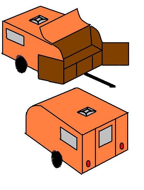

Postby MikeDrz » Tue Feb 07, 2006 11:08 pm
How about this.... front kitchen , squared back. certainly addresses the tandem issue.. straight in the back door. this layout might lend itself to a dinette as well. any thoughts on sealing the front? maybe a "bra" for travelling?
mikeschn wrote:How about having a single member tongue, and get rid of the drop down leaf. Make it part of the hatch instead... The would get rid of all that shin busting stuff, and let you work nice and close...

Postby madjack » Wed Feb 08, 2006 12:20 am
Mike, make a removable tongue and a single hatch and ya got it all. Why a single hatch, well with a single hatch you only have 4 sealing edges/surfaces to worry about instead of 10
