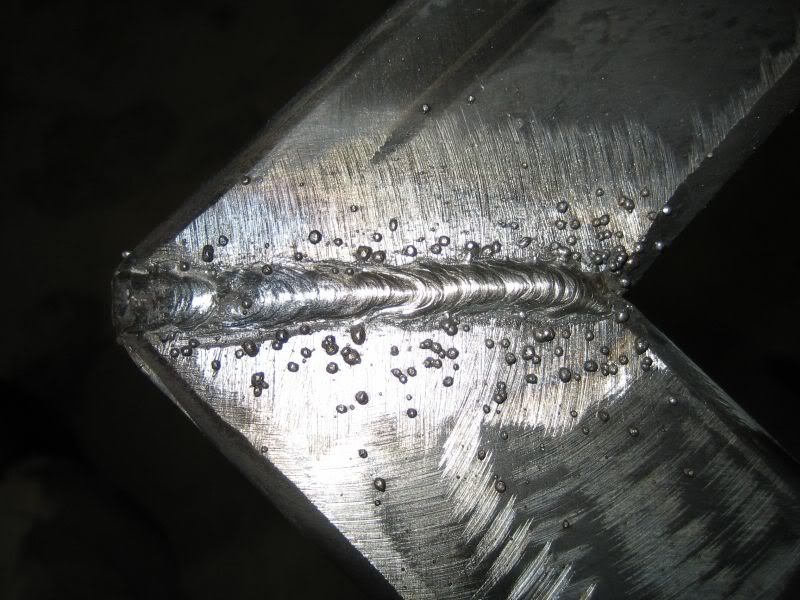

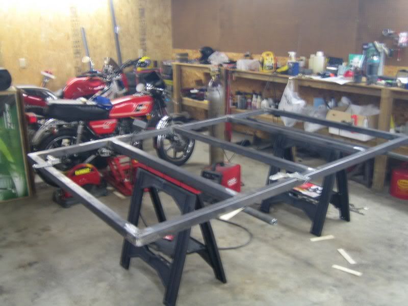

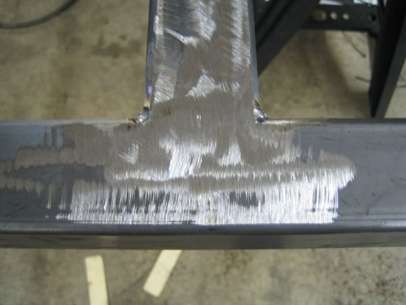

I've got the main frame welded and all my concerns about spatter were for not as I had to grind all the welds anyway to get them flat.
The penetration was very good.
I now know that I should have butt welded as the stitching of the gaps was a little more tedious then laying a bead.
I've gound all the welds down with a grinding wheel, the I went over them with a sanding disk and they look real good.
Photo of an Untouched Weld
Cleaned Weld
My Main Frame

Postby Jim Marshall » Sat Feb 11, 2006 11:23 pm
Bandit, that looks like a really neat job. You shouldn't have any problems with that. :thumbsup:

Postby mikeschn » Sun Feb 12, 2006 6:22 pm
Bandit,
That look nice. Pretty aggressive sanding down there... your teardrop floor should be sitting pretty flat on that though...
Add some bolt down gussets, and you'll be good to go!
