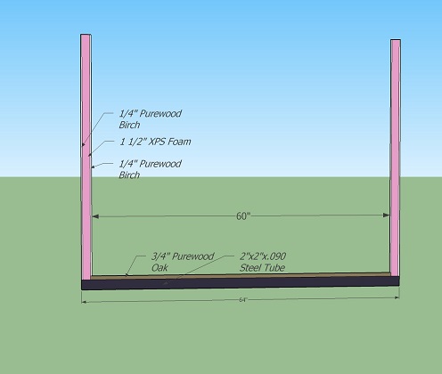

TD Wall structure.jpg (26.97 KiB) Viewed 2483 times
This is the structure I'm considering using on my TD.
Has anyone tried this?

Jeepertrains wrote:
Look at this build. He did the same if not similar to what you are asking about. viewtopic.php?f=50&t=66930
