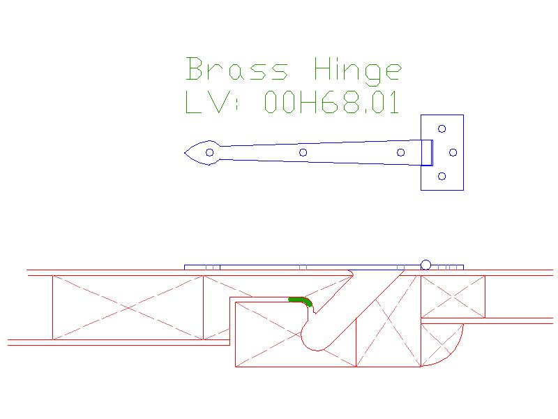

Postby Gadget Man » Tue Mar 14, 2006 8:17 pm
C-Mac
I started out planning to use Grants Hinge, but after a few e-mails back and forth, it was decided that my gap was to wide, or his hinge not wide enough, I had nothing left to screw too. So once again, on to Plan-B.
I went to Austins Hardware and bought a 3" hinge without holes, so I could do my own. I then got ahold of some "Rolled Rubber Roofing"
(Nice flat rubber) and made a gasket to lay under the hinge.
I drilled all my own holes just where I needed them. It turned out Great, and looks real "beefy". (Overkill's The Thrill)
One little tricky part was cutting the gasket 1/4 inch wider than needed,
and getting it stuffed back under the hinge so it was not stretched too tight when it's in the open position.
I then reordered the same hinge for my doors, and did the same rubber gasket again - worked great !!
