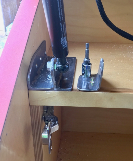

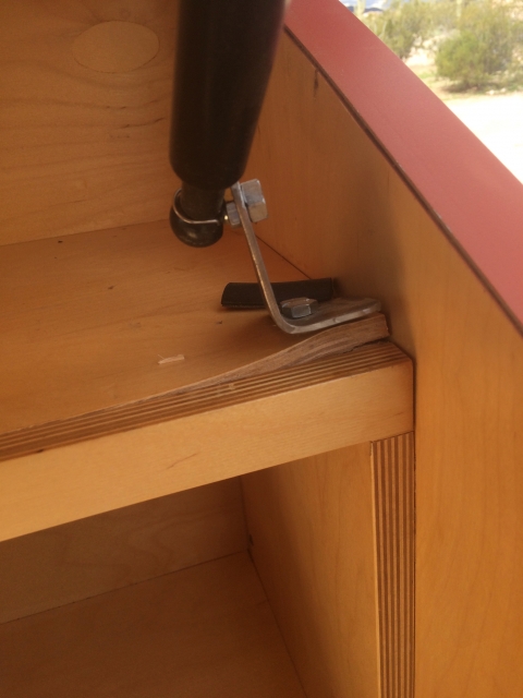

tony.latham wrote:
Are your brackets aluminum Todd?
As he mentioned, I've seen them. They're hell-for-stout steel. And his welds don't look like my turkey-dropping globs. :oops:
Wow! 1/8" steel bent by the struts! :shock:

Postby Aguyfromohio » Wed May 22, 2019 12:47 pm
That's a nice build it's a shame to see it damaged.

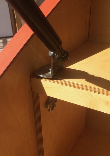

I have only built two hatches with gas struts, but I offer these thoughts.
first, your gas struts seem pretty high force. One of ours has 60 lb struts, the other has 90 lb struts. Yours are 160 lb.
If you move your attach point back from the hinge even a couple inches you may be able to reduce strut forces. Run the spreadsheet again a couple inches back to check.
second, #8 screws seem small. Larger diameter screws like #10, #12, or 1/4 inch have much higher pull out strength.
looking at this table https://www.zillarac.com/Portals/0/Documents/PDF/Screw%20Pull-out.pdf
we see that going up from #10 to 3/8 screws more than doubles pull out strength. Those little #8 screws may be in the wrong weight class for this fight.
Theoretically if you use more screws but smaller screws the system should have equal strength, but real life does not cooperate. Even though ten screws at 100 lbs should be the same as five screws at 200 lbs, the small screws will fail sooner in real life. The phenomenon is called a "zipper failure" (progressive structural failure). One of those screws will fail first because it is in a soft spot, or it's out on the end, or whatever. When it lets go (pop!) the load goes up on all the others remaining, and soon enough the second weakest screw pops. Loads go up one the rest. pop. wait. pop. wait. pop-pop-pop-bang. Like a zipper running down the line. So using bigger screws prevents that first one from letting go. No zipper failure.
There is good reason to stay hopeful and try again. It lasted for while, so you must be pretty close to the failure point, just a bit over the line.
If you can reduce the loads a little and increase the strength a little you will likely move out of that danger zone.

Postby danlott » Thu May 23, 2019 8:59 am
DWT77 wrote:Since my teardrop is 5' tall my hatch came out to be 65" and 100 lbs for the dead weight. Spreadsheet said I needed 39" springs at 162 lbs of force each (Total 324 lbs). I was able to find 36" springs at 160 lbs so I gave them a shot. (I may have used the mounting locations from the 39" the spreadsheet recommended I don't remember if I converted the numbers or not)
Sorry you are having problems. I do have a few questions?
Looking at your pictures I would think that your attachment points are not correct for the stroke length of your struts. Also the force of the struts looks like it is too high.
What is the stroke length of your struts? What is the distance of the attachment points from your hinge point? Also is the length of your hatch a straight line from your hinge point to the bottom of your hatch or is it the length along the curved surface?

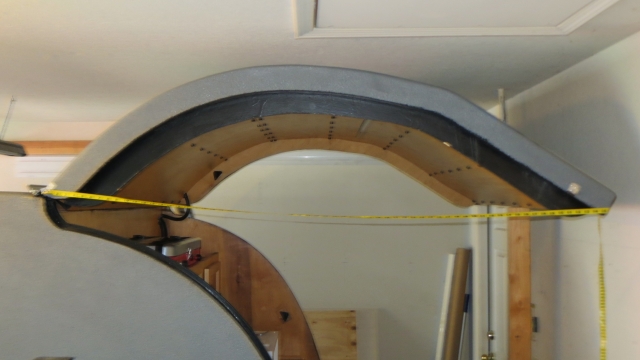

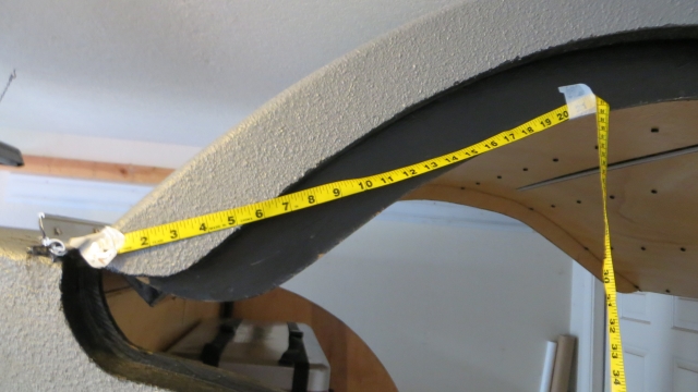

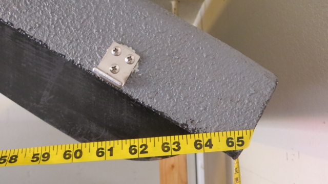

Dan I took some pictures and will try to be detailed so hopefully we can find out where I went wrong.
You mentioned stroke length that got me to thinking about the spreadsheet. I'll get back to that in a minute but first here are my measurements for the hatch
I took the measurement in a straight line.
I tried to do the dead weight again because now I want to re-check everything but with the hinge not secure now I was having an issue with it and not sure if the weight I was getting was correct.
So for now lets stay with the 100 lb dead weight (I will double check when I get the hinge back on)

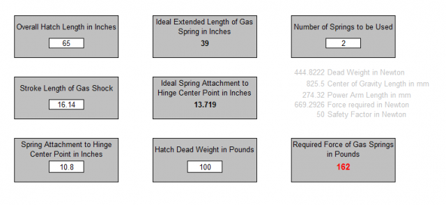

So on to the spreadsheet. When I filled out the spread sheet I used the above numbers. It came back with this
I couldn't find 39" but I did find 36"

I went back to the spreadsheet read it again and looked it over.
I changed the number of springs to be used to 1
The required force in gas springs changed to 312 lbs of force
I was like oh ok the spreadsheet is for each gas spring needs to be the 162 lbs not a total. Which this made sense because even at 2 springs @ 90 lbs each (Total 180 lbs) my hatch still wouldn't stay open
So then I bought these gas springs (Which were the ones installed when the hinge failed)
https://www.liftsupportsdepot.com/lift- ... t-support/
Extended Length: 36.00
Stroke C [in]: 15.20
Compressed Length B [in]: 20.00
Force (Lbs): 150
Which is a total of 300 lbs and is not as much as the 324 lbs the spreadsheet said I needed. (So I think anyways if I did everything correctly)
With all of that said it brings me back to the stroke length you asked about.
The original stroke length on the first set of gas springs was 16.14"
The ones for the last gas springs that failed were 15.20"
I never entered the 15.20" back into the spreadsheet to change the bracket attachment points. (I did change the bracket position a little after they broke loose the first time so not to use the same screw holes)
That is right at 1" bracket mounting difference.
Did I input all of the numbers correctly?
Did I interpret the spreadsheet correctly?
I hope all of that made sense. Please let me know if I need to clear anything up.
Thanks for the reply and the help!!
Hi Wayne,
I wonder if you need to take the entry at C32 in Dan's calculator and set it to the actual distance of the hatch mounting point from the hinge? Since you are using the answer from G26, it should be set to that value (I think). That yields 130 lbs per strut, vs the 162 lbs you are getting. Might make the difference...?
Dan, please tell us if I'm wrong!

Hi Wayne,
Tom that may very well be a big part of the equation/problem I made

Tom&Shelly wrote:I wonder if you need to take the entry at C32 in Dan's calculator and set it to the actual distance of the hatch mounting point from the hinge? Since you are using the answer from G26, it should be set to that value (I think). That yields 130 lbs per strut, vs the 162 lbs you are getting. Might make the difference...?
Yes you should have entered the "Ideal Spring Attachment to Hinge Center Point in Inches" that is in G26 into the C32 cell as shown below.
Since your attachment point is already at 13.72" that is the value I entered into C32 instead of 12.92 which is the ideal attachment point for the stroke length that you have.
This gives you a value of 130 lbs per strut as Tom noted in his post. As a side note if your attachment point was at 12.92" the value would be 137 lbs per strut.
I see a few issues. The first is that the struts that did the damage to you hatch have too high of a force rating. Also the attachment point of 13.72” instead of 12.92” will cause your struts to be compressed greater than the ideal. Gas struts should ideally only be compressed 85%. Assuming that your lower strut attachment point inside of the gallery wall is 36” from the hatch hinge point and your upper strut attachment point on the hatch is 13.72” from the hinge point than your struts would have been compressed to 91% which would have also placed a greater force on your attachment points and galley hinge.
It is very important to know the true dead weight of your finished hatch. The dead weight and overall length will then help you determine the ideal strut length. Once your find struts that are as close as possible to the ideal length you have to determine what the stroke length of those struts are. The stroke lengths of the struts that you are able to find will then give you the ideal upper attachment point of the strut. After you enter the ideal attachment point into cell C32 the spreadsheet will give you the required force for each gas strut. The lower gas strut attachment point should be equal to the overall length of the struts that you end up buying.
It is a little confusing since there are several variables that go into calculating the proper strut force and placement. A change in anyone of the variables affects all the other variables.
I am sorry that you have had these issues. Once you have fixed your hinge and can determine your correct dead weight of your hatch I will assist you as much as possible to located the correct rated struts and the ideal attachment points. You can PM me and we can figure this out together.

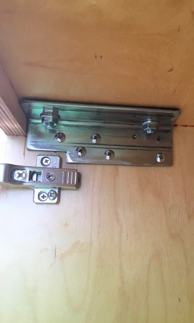

I just found the pictures of the problem I had. I made brackets out of 1/8" angle. And after a few weeks I could see it was bending. Then after a rain and not being in the galley for a few weeks I found this. Not to bad, the top of the cabinet is pulling up. This was the drivers side.
This is the other side. :shock: This was a pain to fix.
My solution, over build out of 3/16" flat bar. The old one is next to it, and you can see it is bent.
This is the inside of the cabinet. So far so good.
I don't have any pictures of the hatch side but I mad those out of 1/8" angle. I'm going to remake those to just to be safe. I'll try to get some pictures tomorrow.
I need to paint them or take and get powder coated.
Todd

That looks like a good fix that will transfer the load to the wall, so it doesn't bend the counter Todd. So, from the direction the counter bent, it looks like the attachment point on the counter is closer to the hinge than the attachment point on the hatch, so that the strut, when the hatch is closed, is pushing toward the bulkhead and up? Is your configuration similar to Aggie79's (Tom's) in that way, as he showed earlier in this thread?
With that configuration, I think an adjustment may be necessary to Dan's spread sheet (or at least in how we use it). I was going to ask him about this in a PM, as my hatch build got further along, as I too, am now thinking about building with that strut configuration. His spread sheet assumes the attachment point on the hatch is closer to the hinge than the center of mass, and it computes the strut force using that ratio. Reversing the attachment points, the attachment at the hatch will be further from the hinge than the center of mass, and so less force on the strut should be required (if I understand the mechanics correctly). Dan, once again, please correct me if I'm wrong.
If in fact, one uses the calculator for the original configuration, and then simply reverses the attachment points for the hatch and galley wall (or counter), I think the strut force the calculation yields will be too strong.
