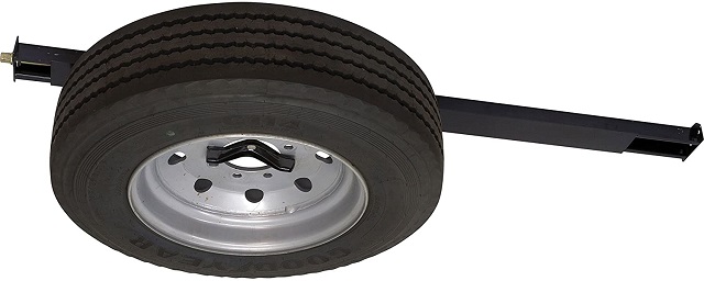

Has anyone looked into this "Retract-a-Spare" for the undercarriage?
On my last build, I was toying with a run to the junkyard to salvage something like this but in the end, I chose not to because of the loss of clearance.
We spend too much time in the boonies where the two-tracks that lead to our camp spots sometimes aren't nice.
:frightened:
I think it would be a good idea for a teardrop that stayed near the pavement.

eLink wrote:Has anyone looked into this "Retract-a-Spare" for the undercarriage?
https://www.amazon.com/gp/product/B07D1 ... 0DER&psc=1
That's the kinda thing I was talking about salvaging from a ute back on page one. I didn't know you could just buy a nice ready to go set up.
