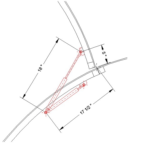

angib wrote:Here is what Grant Whipp recommended for mounting gas springs:
"Most galley lids are 44-48" hinge-to-threshold, and here is the mounting that has worked for me for nearly 20 years:
Pivot point on the lid - 5" down the rib from the hinge
Pivot point on the wall - approx. 17-1/2" down the galley wall from the hinge, and in just enough to clear the lid framing.
I build a fairly light weight lid, and on a 4' wide teardrop I typically use 45-55# gas struts, 18 to 18-1/2" long in the open position. Most retail outfits will let you exchange for a heavier set if you need to.
Grant's origonal post in full is here.
Andrew
