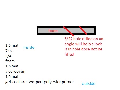

I'm thinking of drilling a series of small (1/4") holes in mating surfaces on slightly different angles.... so when the adhesive is applied it would fill those holes and act like little anchors for the adhesive
stops any movement but we have found you don't need to fill the holes all the way up for the added weight makes your bonding much deeper

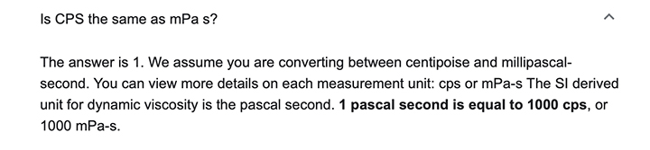

PL3X is 550,000 CPS whereas the 939 is 150,000 mpa
What the difference on CPS and MPA.
We are building like saltydawg with a bound beam around the top. pl3 seam to work fine and fills any gap we are using $9.68 for 28 oz

saywhatthat wrote:What the difference on CPS and MPA.
Two different methods of measuring viscosity. You can google it for more info but they are basically a 1:1..... meaning (for example) a viscosity of one substance with 10,000 CPS and another substance with a viscosity of 10,000 mpa will be similar (the same) thickness. I don't want to give the impression that I understand all the science behind this....... but just the basics :)
There are also many charts available that will give you comparisons, for instance the thickness of honey, catchup, etc. You can then compare it with materials that you are using (adhesives for example) to get an idea of how viscous that adhesive will be.

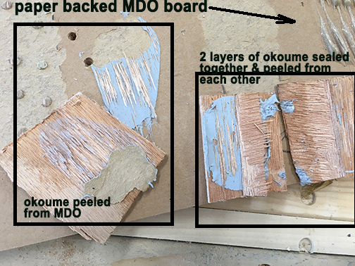

Reporting back with "testing" results. I received the Teroson (Loctite) MS939NA and tested that against the PL3XPremium.
The original problem: I'm using okoume ply for the inner and outer layers and paper backed MDO 3/4" ply for the middle skeletonized member for my wall assembly. I had mistakenly urethaned the okoume layers prior to the wall sections being assembled. As a result, I was concerned about any adhesive effectively holding the urethaned layers together.
For the testing I applied urethane to the okoume and let it dry for more than 24 hours. When doing the adhesive testing I let the joints cure for a bit over 24 hours. When testing the PL I found the weak link was the paper backed MDO. The PL seemed to have stuck okay to the urethaned okoume but easily pulled the paper off the MDO when the okoume was pried from the MDO. The 939 was a different result. I've never used this adhesive before. It's really tough stuff. I've attached a pix of the results. You can see, for the most part, the okoume wood actually ripped apart from each other (a good thing). The 939 must penetrate into the paper of the MDO somewhat. I adhered two pieces of okoume and also okoume to MDO. Both resulted in the wood pulling apart for the most part. The 939 doesn't reach it's full cure until after 7 days (24 hours for PL). I did the testing after 24 hours, so over time the 939's bond should get even more better. So the 939 gets my vote for assembling the wall sections.
I went over the okoume panels with the orbital sander using 80 grit discs to somewhat remove the urethane a bit..... I haven't yet assembled the panels but feeling, in the end, using the 939 should be okay. The okoume outer layer also will get stapled to the paper backed MDO so not at all concerned about those 2 layer's adhesion ... it was the inner layer that I was most concerned about, since I'm not planning on using any fasteners and just relying on the adhesive.
Another lesson learned.
John
The image below shows the results of the 939 adhesive.
