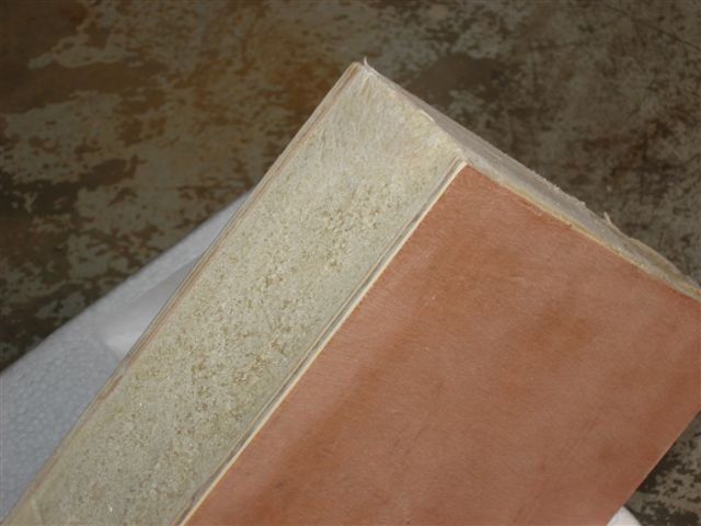

Well here goes. I took some pics of my sample SIPs to share. They are just rough experiments but they are stronger that I could have imagined. The polyurathane really bonds to the wood totally. The only way I could separate the sides of a small test panel was to fracture the foam.
FIRST TRY
This 2.5 inch thick SIP was made with two sheets 5.2mm Luan ( 12" X 12") held in a U-shaped frame while the polyurethane foam was poured into the verticle cavity. I lined the frame with waxed paper so it wouldn't stick. I sanded most of the paper off but it is still present. I just dampened the plywood and poured the foam into the three sided cavity. I cut the excess foam that came out the top off with a hand saw.

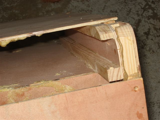

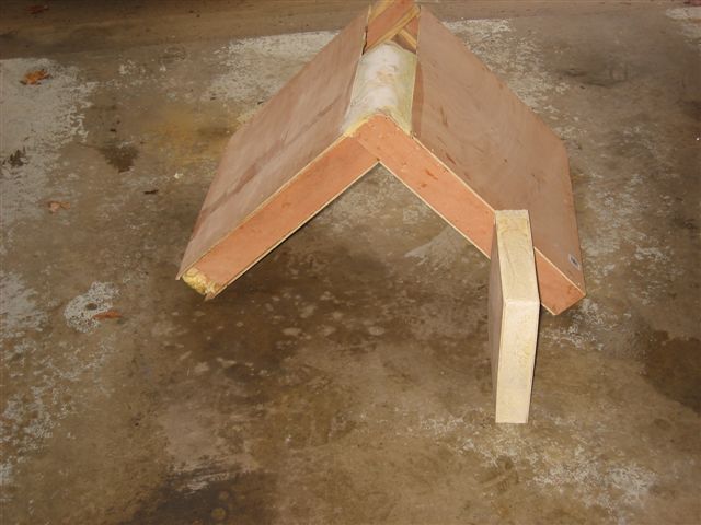

MORE AMBITIOUS
Here you see my first attempt again as well as a second attempt of larger scale. I wanted to see how I might fasten panels together so I built a sample joint between two 2' X 2' wall sections (now 3" of foam) to simulate the junction of two walls or a wall and a roof or floor. The bracing was 12" centers which is too close for real life. Probably 24" would do. I filled only half the structure with foam. This 3" foam R-22 wall fully filled would be weigh about 3 lbs. per sq.ft. of surface area as built including joints. The smaller sample without supports was about 2 per sq.ft.
STRUCTURE
I built stringers of luan and 1X1 strips (stringers glued with polyurethane glue and stapled) that extend a few inches past the plywood. This way the stringers can be joined to hold the panels together. This shows the unfilled cavity and stringer (I-beam).

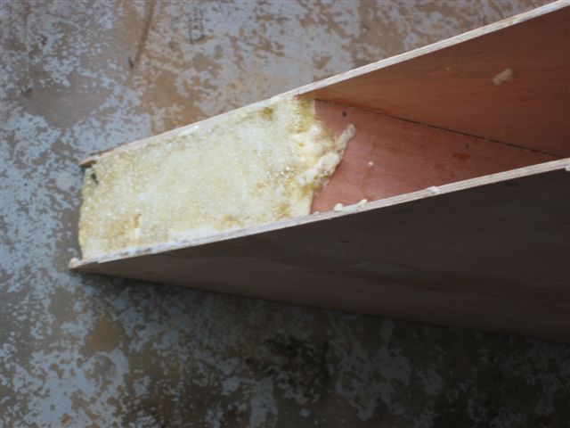

EMPTY CAVITY
This shows the foam filled cavity next to the empty cavity. I didn't have enough foam to fill both. I built the structure. foamed one wall and put flexible poster paper around the open joint (where stringers meet I rounded their profile) and foamed the rest,. Then I pulled off the paper I had the rounded shape on the external corner. This would need fiberglass or some other covering.

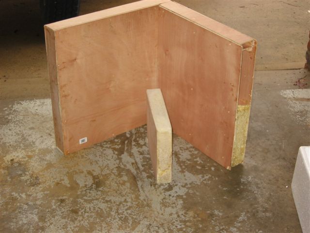

OUTSIDE CORNER
This shows the external corner that needs some kind of covering. Fiberglass of aluminum flashing might work.
The way I joined the panels was just a hairbrained idea that may or may not be best.

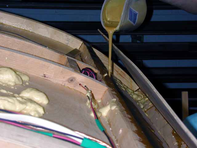

This stuff probably looks familiar... We poured my roof foam this weekend. (2lb/ft^3, 2-part) :D
You're right about strong. This stuff is tenacious. The little mounds to the left in the picture were extra in the bucket of a previous pour. I'm impressed with the gripping strength and hardness of this stuff. With 1/4" outside skin, the bays of the teardrop are rock solid. Now that I have some of this stuff, I think I'll add it to the SIP test I'm probably going to do this week. (didn't get to it this weekend)
Now to finish the rest!
How did your volume calculations and foam expansion match? Did you just make extra? I found the foam didn't quite expand as much as it should. I think the desired temp was 75-80, and I was only around 68-70.

Postby Artificer » Sun Mar 12, 2006 11:22 pm
captainsam wrote:I noticed you are pouring on the surface between the frame members and under what appears to be the roof skin.
Are you cutting the excess foam off flush or just closing the cavity and allowing the foam to expand to fill? If you overfill, where does the excess go? Could the pressure bow the skin out? I'm just not sure how you are doing this and I'm curious as I want to have a curved roof too.
Just closing the cavity. That way the foam bonds to both skins.
The procedure I used: apply glue to first bay, and staple plywood across the bottom edge. Make sure everything is ready, mix, and pour into crack exposing the cavity. Bend plywood and staple shut. Wait to see if its filled.
I have 1/2" holes drilled through the center of spars, 6" on center. It lets me check the fill level. The idea was that it would allow pressure to be relieved. The calculated foam amount never seemed to fill the bay. Some of the second bays foam dripped trough the holes, however, so I think I've gotten a decent fill. I'll probably drill some inspection holes in the exterior skin. If necesary, I'll use great stuff to finish the fill. The tube should allow me to get into the cracks. I'll have a painted exterior, so bondo and fiberglass patches are no problem.
My interior skin is 1/8" birtch, and the exterior is 1/4" maple. The 1/4" was a pain to bend, but didn't show any bowing, probably due to the curve. Didn'tn notice any bowing of the interior skin either. The two stage fill probably helped. After 20-30 minutes, the foam is hard and fairly strong. It can probably stand to be overfilled then.
This insulating method is slow, costly ($70 for my 8ft^3 kit w/shipping), and somewhat a pain to do. However... it has an extreamly high "coolnes factor" that I couldn't pass up, as well as making an VERY strong roof. I can probably dance on it without denting it.
