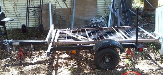

My 4'x8' trailer was designed for a solo camper, either for my wife to use when "bigfoot-hunting" with her group, or as it turned out, for me with my new-found camping friends. The basic sizing was based around using a traditional 48" x 96" plywood sheet for a base, and around a 38” x 75” twin-size mattress as the inner-cabin size. My wife is 5'4", and I'm 5'10.5", so there would be enough space for either of us, or perhaps even both if that was to occur.
old twin-bed frame placed atop my derelict/broken/unused for 20 years, $50 swap-meet special trailer as a size test
twin on trailer base,before extension.JPG (52.77 KiB) Viewed 906 times
I placed the 3/4" thick walls on the top of the floor, which made the overall inside dimensions 46.5" x 95.25" (front wall on top of, rear hatch abutting/overhanging the floor), and the rear bulkhead was positioned at exactly 75.25" from the front wall, leaving 20" for the rear storage/galley compartment). When I was trying different mattress and bedding configurations later on, after each trip, I found that it took both my wife and myself to reach in from both sides to change bedding, so perhaps I should've left a longer space for the mattress, and reduced the galley space a bit. I eventually ditched the mattress and bedding altogether, going to a 75"L x 39"W x 4"Th quad-fold mattress (with durable cover, folds up enogh to fit thru the door) in conjunction with two king-sized pillows and my choice of summer or winter-weight sleeping bag (both are taken on every trip, since Texas weather is so unpredictable).
