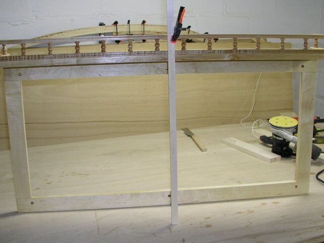

Why not just say the heck with miters? I looked at my old house today and saw that they didn't use miters... so today, I didn't either...
Here's the plan...

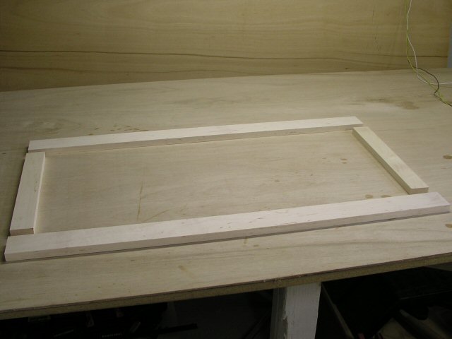

Postby mikeschn » Thu Mar 23, 2006 8:42 pm
And here's what I came up with... who needs miters... :?

Mike, I couldn't agree more. In fact, here's a "snappy" of my inside cabinet face. I skipped the miters, even though I have a nice Delta power compound miter saw, and went with butt joints with pocket screws.

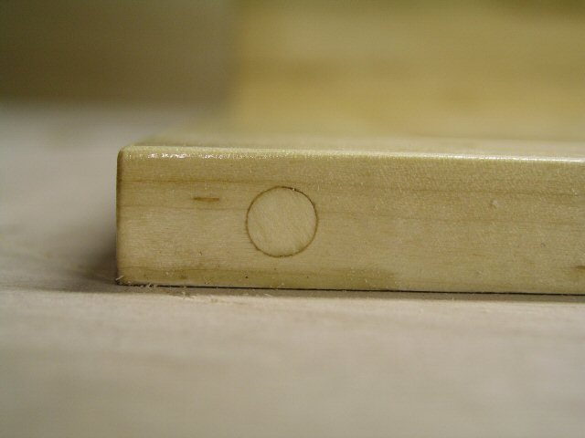

I didn't even use pocket screws... I drove my screws in from the end and plugged the holes... What could be easier? :lol:

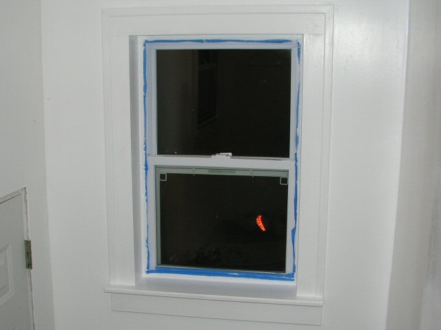

But that is my framing for around a window...
Looks just like this framing I did around a window a window a few days ago...

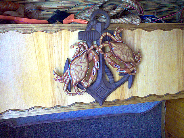

It's for scalloped trim around the cabinet openings, so yeah--I thought I should miter.
It's gonna be weird though, because here's the molding we're taking about:
Is it going to be possible to make correct corners with this kind of molding? Now that I think about, the dimensions to my openings may not even ALLOW it, that the scalloping won't match up.

I think the border is great. If the scallops don't look right with the opening perhaps you can put the scalloped part into the opening and the rest as framing.
If your corners don't come out perfect use some wood fill for the gaps. If you use the good stuff it shouldn't show.
Glad you tried it anyway,
I personally would not miter a frame that was going to have a door. So I guess I agree with the others.
However, you requested info about mitering and my personal opine is that you practice. You might supprise yourself.
If you cut your pieces together or at least mark where on the molding you want to match at your corners, you should be ok.
