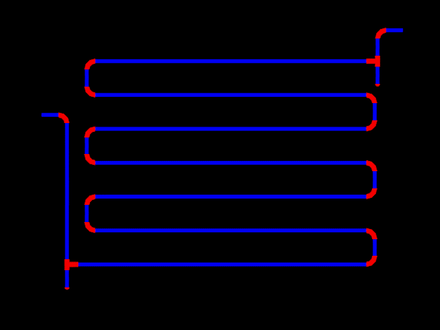

Ideally what you want is your water seperator and filter at the end of a long run of metal pipe. The pipe acts like a radiator cooling the compressed air and allowing water to condense. When setting up a shop for spray painting I take half a dozen sticks of inch or inch and a half black iron pipe and join them together with either street 180s or a pair of 90s and a short nipple. Mount the pipe to a wall.
EG:
Hot, water laden air comes in the top at the right. Is cooled by the pipe as it zig zags to the bottom. Water condenses and runs into the bottom of the T fitting on the left. The T also acts as a rust trap. Nice cool dry air is extracted from the elbow on the left where it goes to a silca dryer and filter. Both Ts have ball cock valves on the down pointing leg to allow water to be drained.
PS: automatic oilers shouldn't be used with hoses that are used for painting.

Postby Mitheral » Fri Apr 07, 2006 5:03 pm
Artificer wrote:Get a large bucket/bushel basket/barrel. Coil the first set of hose after the compressor in the barrel. Then put a filter in line, then the rest of the hose to the sprayer. Cover the hose with ice and water. This system works even better if you combine it with the roll of copper tubing idea
Also if you've got a fridge in your shop you can run your compressed side thru 10-12 feet of copper tubing coiled up in the fridge. They actually make refrigeration units designed for this purpose. Make sure to T off an drain at the exit end.
Mitheral
