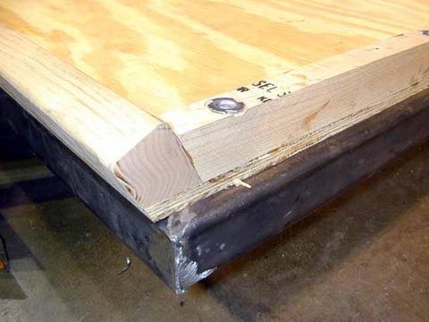

I used stainless steel deck screws screwed into the wood frame through the steel frame from the underside.
Joseph
bledsoe3 wrote:I used 10 carriage bolts. 3 on each side and two on each end. I used a forstner bit to sink the head of the bolt. The bolts went thru the floor and a piece of angle I welded to the frame.
Chris C wrote:Rocky,
I plan on doing the same. A carriage bolt, after all, doesn't protrude that much, and when material is cut away from the floor to lower the bolt head, one is just weakening the holding power..............although, I'll admit, minutely.
Larwyn wrote:I used six 3/8" carriage bolts. That's two more than GM used to hold the bed down on my truck. Should be plenty.......
