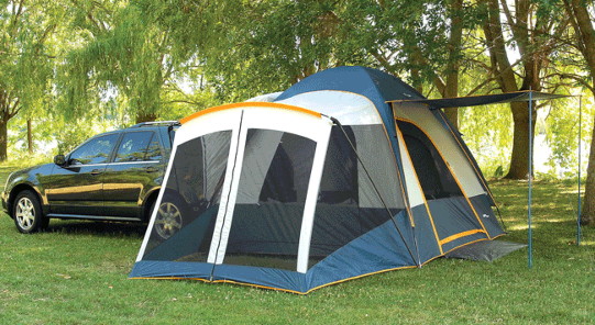

Ira I don't have any clear shots of how I attach it. The "boot" part of the tent wraps around the front edge and side of the tear. I stap the boot in place across the top of the tear with bungee cords. The bungee cords go over the top and attach to the frame on the opposite side of the tear. I then tuck the window flap of the tent under the matress (you can see that in the above pictures). I also have a rain fly/awning that I mount across the top of the tent. I position it so the awning part extends over the tear. This helps shed any rain water. I hope that makes sense. Next time out I will try to get some clear shots.

This is the tent that I have.

My SPORTZ just arrived. It is #83000, new for 2008. Basically at this point you get on a list and they ship to you after they receive a shipment.
It's similar to the one above. It is 10' x10'. The rain fly door is on the opposite side from the sleeve. The end facing us has a removable 7'6"X10' screen room. It is without floor and you can leave it that way, or buy a cloth from SPORTZ or you can use vinyl or rug or even an ex-wedding dress.

The 2008 Napier Sportz SUV 83000 tent transforms your vehicle into a home away from home, no matter where the trails take you. The Sportz SUV 83000 tent wraps around your vehicle’s rear end, creating a shelter large enough to accommodate two campers in the cargo area and another six in the 10-by-10-ft. tent area, with plenty of room left over for storage. A seven-by-six-ft. detachable screen room lets you enjoy meals al fresco without the worry of uninvited winged or legged guests. Two large entrance doors, three No-See-Um mesh windows and two skylights provide ventilation. Come rain, the fully tape seamed rain fly is handy. Come shine, you’ll be relaxing in the cool shade of the six-by-six-ft. awning. Remove the sleeve to turn the Sportz SUV 83000 truck tent into a standalone tent. Napier.
:sweaty: I think the versatility of these tents are great. we just got it and in light of the rain and 100 degree weather have NOT put the tent up yet! The fly appears to be capable of rotating in directions over the main tent.
I wondered if there was more needed to cover the sleeve joint for rain. Hadn't thought of the fly.

Oh, ok! :lol: We are planning on shutting the door... not that it is relevant. The PetCool (heat or cool) will sit by the left rear wheel.

My tent has small mesh areas in the ceiling/top as well but it also has nylon flaps that zip closed to cover them.
