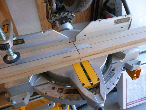

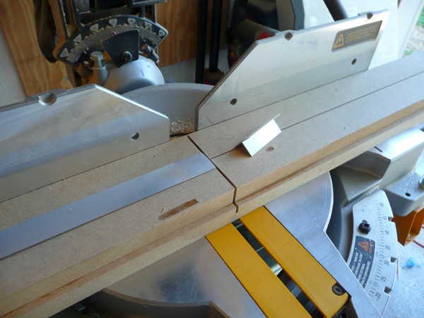

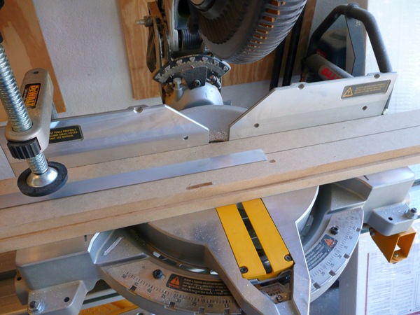

thanks for the welcome! ':D' yeah, the most important thing is the 0 degree or negative degree hook to the tooth. I use the triple chip tooth for thicker stuff like 1/8" or better but use ATB for thinner stuff like metal laminates. you're right, the triple chip is a bit aggressive and leaves a ragged edge on thin stock. the WD40 just helps keep the aluminum from sticking to the blade and gumming it up. it's not really needed for cutting but it does help keep the blade clean.halfdome, Danny wrote:Afreegeek, welcome to the form from another Cabinetmaker.
I see from your post you recommend a triple chip when in fact the link you refer to the blade dosen't have a triple chip but is almost identical to my blade but of a different brand. My blade has 80 teeth. I never had the need to spray WD 40 to have it slung all over my face shield.![]()
I wouldn't recommend a triple chip when cutting non Ferris metals, it's too aggressive. IMHO.Danny
