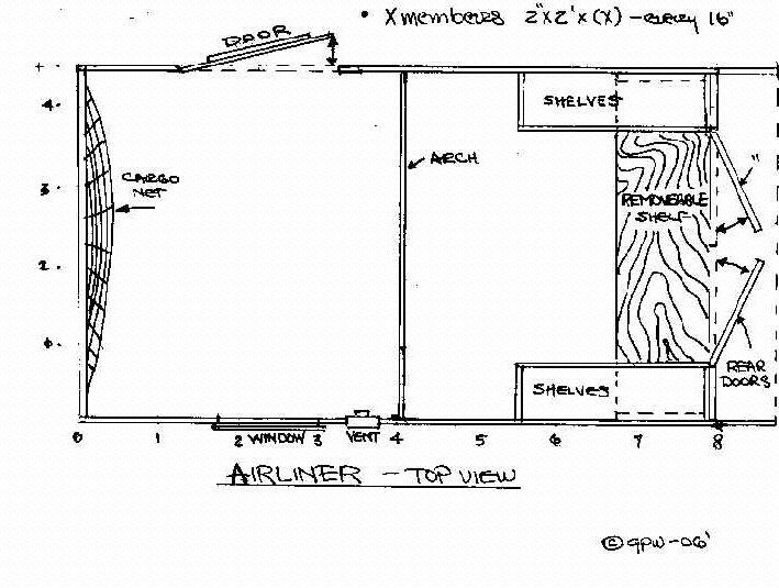

Got the floorplan done ... here's my attempt at getting it here...

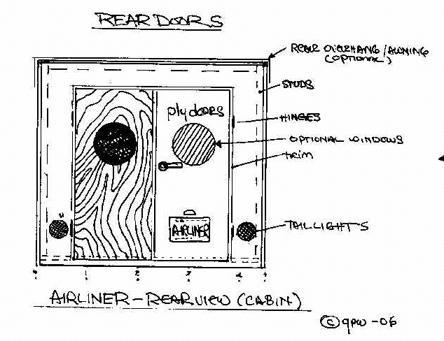

Here's a drawing for the twin rear doors .... schmaybe ' a bit more convenient than a single WIDE door ... Image
Postby Arne » Mon Oct 02, 2006 9:23 am
I like the double door better. If you open them 90 degrees, under the overhang, you get sun, wind, weather protection.
You could include a fold down counter top, put shelves in the doors for light-weight items, like paper plates, etc.

Postby Miriam C. » Mon Oct 02, 2006 10:50 am
:applause: I like the double doors too. A removable shelf might be a pain. Waiting for the wood pictures. :D
Postby Jay VT » Mon Oct 02, 2006 12:21 pm
How about an awning that conects to the roof and uses the doors for support. :thinking:

Postby GPW » Tue Oct 03, 2006 8:15 am
Arne ... You were right , the double doors are a better idea and I'm still able to build onto them for "incidental storage ex post facto "...The removeable shelf on the plans will be able to easily fit along the drivers side wall , secured out of the way when not needed ... I'm trying to keep it REAL simple!!! (read too many ultralight threads ) :lol:
M ... Pain ???? Shelf is made with an edge lip that makes it stiff, and does not allow things to fall off the edge ...side storage allows much more storage /utility /foot (if yer' tall) space...table when you want it ...
The overhang would have a space under the rear to accomidate a small awning rolled up on a Dowell ... a PVC storage tube under the frame would carry the awning poles and fishing rods...old school ...
Jay .... Doors are gonna' be kinda' short for any awning support,eh??? .... poles are better cause' you can use a bigger awning and hang more Chinese lanterns.... :thumbsup:

Arne wrote:I like the double door better. If you open them 90 degrees, under the overhang, you get sun, wind, weather protection.
Or with an extra long set of strap hinges you could have the doors open 270 degrees and fold back along the body completely out of the way.

Or Perhaps opening the doorfrom the bottom(swingup) , so the door would become the awning ??? The hinging , a simple piano hinge on the top ... waterproofing is no problem because the hinge line is under the short overhang in the back ....simple and effective ...just another idea to sort ... :thinking:
