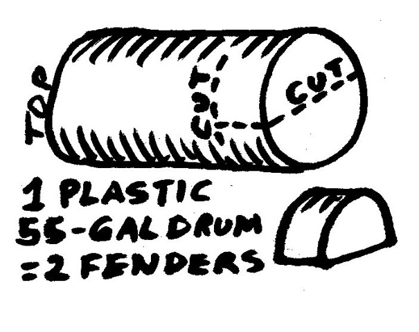

To go ultra-light weight, I considered buying a 55-gallon blue plastic drum. Cut drum in half vertically. Use the bottom as an attach point on the trailer. Go up the side of the drum as far as needed to get the fender outside the edge of the tire, and cut drum off there. Done right, one drum = one pair of lightweight, waterproof, non-rusting fenders. They could bolt to the trailer side with three bolts.

The trailer axle has a square plate on the back with four holes, so it's now possible to make straps that can attach to the axle and to a fender. This would have the fender riding on the axle, so my unsprung weight would go up. The kightweight 55-gallon drum fenders would still work, since there is 2" between the side of the trailer and the side of the tire. Steel fenders would also work.
How about some discussion about the pros and cons of using ultralight fenders, steel fenders, and mounting either on the side of the trailer or on the axle?
