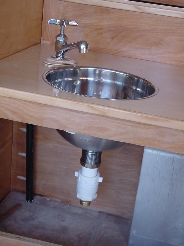

sunny16 wrote: th sink, doesn't drain reall well since it is a flat pan but it drains enough for what I need. It leaves just a trickle of water in the bottom. Paper towels take up any excess if needed.
Same here--I used the same pan, and the same thing:
A little water left in the pan, but not a big deal.

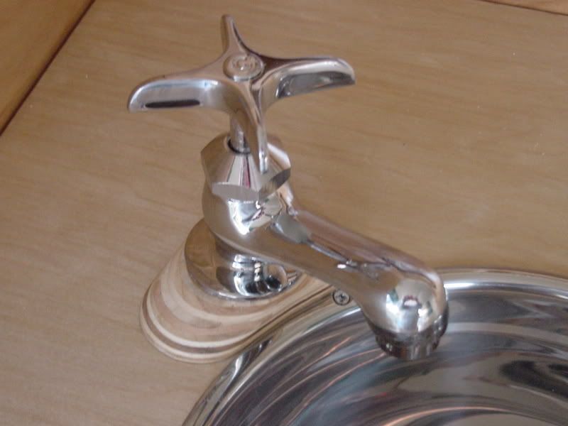

Postby Mary K » Mon Feb 19, 2007 11:39 am
Well I have my sink installed.
I went to Lowes Friday night and well... they suck!! I couldn't get what I needed in the plumbing dept to go from the bottom of the sink to a hose fitting. It was an Ira experience to say the least..
Anywho, Saturday I went to the local Ma & PA Hardware store, ya know the one where there is so much crap in the isle only one person can walk down it. Well they set me up. As you can see from the picture, the sink is fitted out to a Male hose fitting. That will work for now. They also had the single basin Tap I have been looking for!!! Saweeet!!!! (AND I had no less than 6 employees ask if I need help!)
I strapped my belt sander down to the worktable and made this stand off to lift the tap higher over the sink.
I have more detailed pictures in my build pics linky. If you have any questions about the parts just ask, I will try to help.
