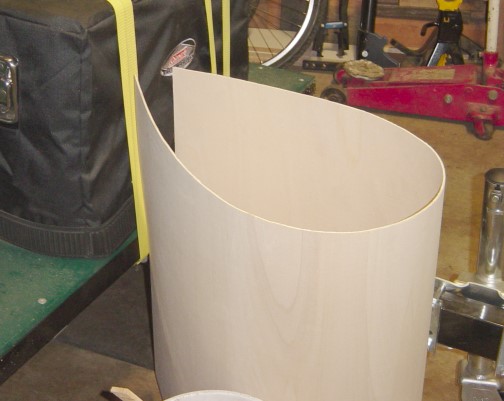

How the heck do you guys bend plywood?
Postby schaney » Fri Feb 22, 2008 2:23 pm
Here is some of the "Bending Birch" Madprint mentioned. This is 1/8" and it easily bends to a 6" radius. I use it around the cockpit of kayaks in making the coaming ring. It is on the soft side, not sure it would be a good choice for a Teardrop roof, unless it was covered infiberglassed. Although it would be very lightweight.
Scott

Postby madprinter » Sat Feb 23, 2008 10:19 am
Thanks for the pics Schaney. I got tied up with work and did'nt have time to get them on. I agree it is a little soft, but that could be overcome with enought staples on the ribs, of corse then you'd want to cover the staples or fill them.
