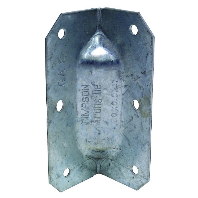

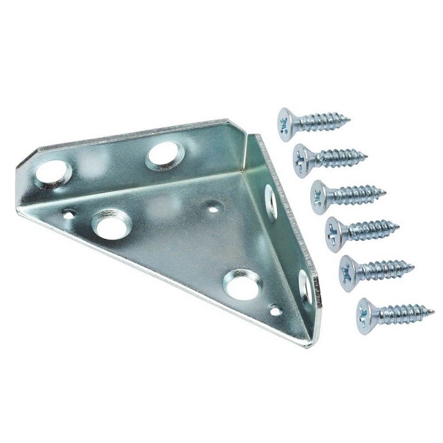

Postby working on it » Sun Nov 17, 2013 12:27 pm
Esteban wrote:I bolted the floor to the trailer frame. The walls were then glued and screwed to the floor.
So did I, with differences. Bolted the floor to the frame with 3/8"-16 carriage bolts, with 36 (?) TEK screws around the frame perimeter. On joining walls to floor, I used 1/4"-20 stainless carriage bolts (with stainless fender washers and acorn nuts) instead of screws, and Everbilt corner braces at the corners (of course),
corner brace.jpg (62.87 KiB) Viewed 40850 times
and Simpson Strongtie GA-2 angle pieces along the walls.
Simpson Strongtie GA-2 angle.jpg (94.16 KiB) Viewed 40850 times
I enlarged the holes on the corner pieces to accept the 1/4" bolt, and did the same with the hole in the center flats of each angle piece, also. Every inch of joined wood-to-wood interface got a 3/8" bead of Loctite PL Premium Adhesive as well. Once joined, and prior to painting the interior, I also used PL adhesive as a "caulk". All material is from the big orange box store.
