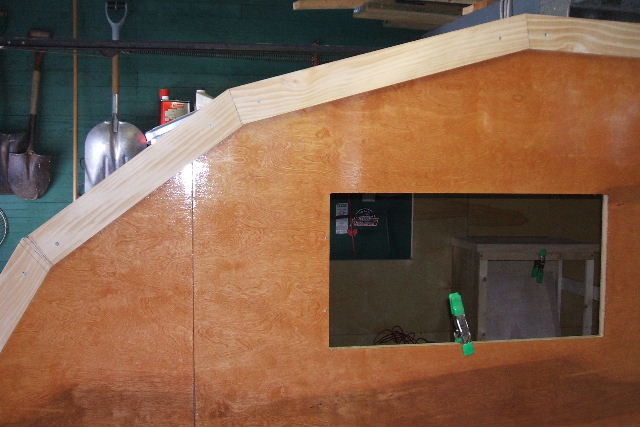

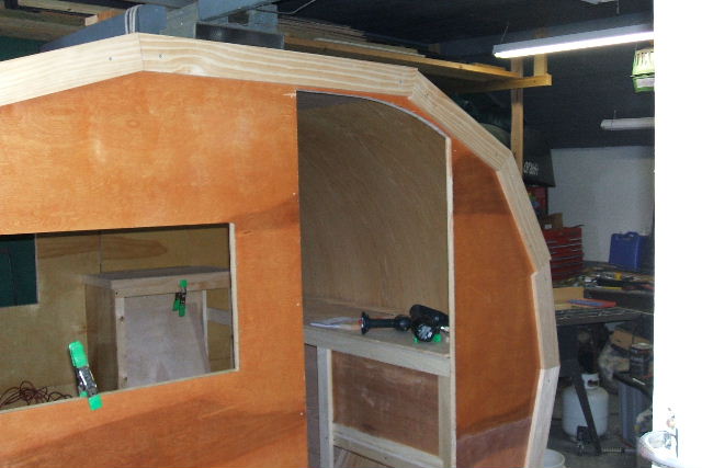

Postby WarPony » Sun Mar 22, 2009 1:02 pm
Well, here is the fruits of my labor for the past 4-5 weeks:
Here is the trim boards cut and screwed to the walls before I used the router to trim the outer curve.

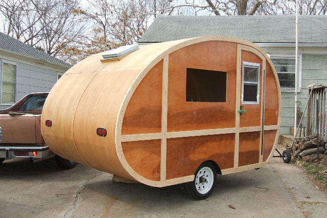

Here's the trim after much jig sawing and sanding.
I'm not sure if I'm done or not on this side. I'm going to trim out that small AC window but there seems to be alot of empty space. Do you guys think I need to add a vertical piece to kind of fill it in?
I don't know if I'm going to stain or paint the trim. Anna likes the way it looks now but I was planning on painting it a dark brown. Any comments/suggestions on that subject?
Jeff

Postby Dean in Eureka, CA » Sun Mar 22, 2009 1:40 pm
That's looking good Jeff! :thumbsup:

Postby 2bits » Sun Mar 22, 2009 1:54 pm
I'm not sure about the extra trim, I think it might need something though, here's a couple of quick renderings to give you an idea though!
I like this one myself:
Personally I really like the trim light, but here is it darker, sorry I don't have Photoshop anymore, so I rednecked it :)
No matter what is looks great! ! I think the trim worked our beautifully!
for me, I am still leaning to using a full 4x8 sheet of 1/4 or 1/2" plywood and cutting one continuous piece from it, round it off on both sides and that would cover the whole side all the way back to the hatch and wheel well. It will be a challenge for me though since I already have the aluminum trim around the top, so a laminate router but is not gonna fly (hindsight).

Postby WarPony » Sun Mar 22, 2009 2:01 pm
Thomas, can you frame that little door in and put a vertical rib in the middle of that door? Not going totally through it but just joining the top and bottom of the door.
Good work, redneck or not!!!

Postby 2bits » Sun Mar 22, 2009 2:20 pm
WarPony wrote:Thomas, can you frame that little door in and put a vertical rib in the middle of that door? Not going totally through it but just joining the top and bottom of the door.
Jeff
Ahh I get it... I think you got a winner there! :thumbsup:

Postby WarPony » Sun Mar 22, 2009 2:30 pm
2bits wrote:
WarPony wrote:Image
Just what I wanted, Thomas!! Hmm, I'll have to mull that look over. I'm leaning toward the very first pic you did.
Thanks, bud!!
Jeff
