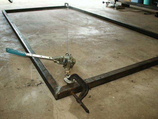

Postby Steve_Cox » Sun Nov 02, 2008 7:56 pm
Here's a pic of my frame straightener.
Steve

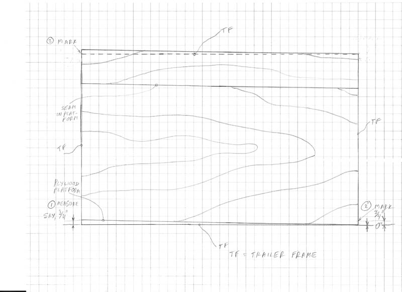

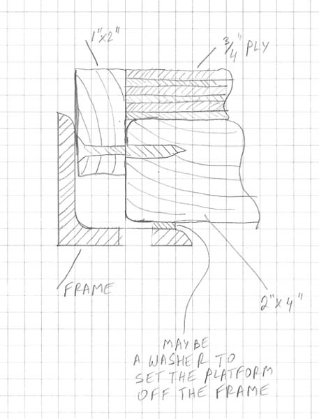

Postby reiltear » Sun Nov 02, 2008 7:59 pm
Hi Mandy!
I'm sorry, I guess I'm a little late with my post. I had an idea that might have helped.
If you measured your plywood frame and cut it parallel to the corner metal in your trailer frame, I think it would have been a fairly easy matter to fill those gaps with some straight wood. Just glue and screw the daylights out of it and then reCPES it.
The walls would have covered the new seams, or, if not, corner round would.
I think that the trailer being 1/8" out of square(unless I misread one of your previous posts) isn't that big of a deal. How clean are the corner welds, etc.?
And don't despair, the only people who don't have "learning experiences" are the ones who don't do anything.

Postby rhltechie » Sun Nov 02, 2008 8:10 pm
reiltear wrote:Hi Mandy!
I very much appreciate your putting your time into making a sketch for me...it's hard to find good people elsewhere to put in this much effort to help someone they do not know!
steve, miriam, and kerry...i think you all have the same main idea of the whole getting the trailer square thing. I will def try this after i get my floor framing back together :( as for the axle measurements, they are the same on each side. it just seems to be a little out of square, so hopefully i can pull it in and move on from the floor...finally!!

Steve_Cox wrote:Here's a pic of my frame straightener.
" You'll put your eye out kid " ( Santa to Ralphie Parker)
Postby S. Heisley » Mon Nov 03, 2008 10:33 am
So, you straighten it like you would a fence gate. :o Who'd think you could do it with something that big...and heavy metal at that! When you see a picture of it, it looks do-able. :thumbsup:

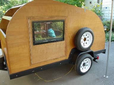

I had a similar problem with the same trailer when I was helping my friend Kate build her convertible td. Look closely at the front and rear profile to see the uneven area.
We made sure the floor was level and then simply hid the frame with trim at the end of the build..........just like Steve Cox suggested.

Metal has a memory. Chances are, the frame got tweaked out of shape during shipping and will pop right into square when you do what Steve and Kerry demonstrated here. But, it's also possible that the pieces of metal were out of shape when they were made into a frame. If that is the case, the metal could 'remember' and pull back to its original wacked-out shape. After you tweak it, you might want to take it down a bumpy road to see if the shape holds. If the shape doesn't hold, you'll definitely want to hide it.
