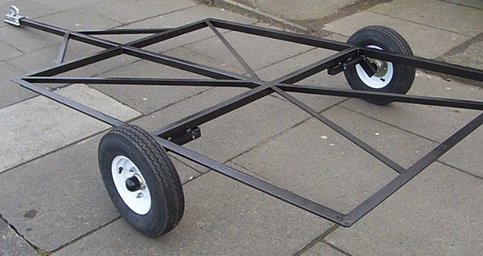

Postby Dewi » Sat Mar 14, 2009 8:21 pm
A member from the UK posted up a link of a trailer chassis builder... question is, is this going to be strong enough for the TD I want to build? (ie front galley and Winter Warrior style rear)
It's built using 1.57" x 1.57"mild steel angle and 2.57" x 1.57" mild steel box section, comes with a jockey wheel (not in picture) and independant suspension. Oh and 9" wheels.
Will I be able to use this, or am I looking at something more beefy?
Cheers, Dewi

Postby kennyrayandersen » Sun Mar 15, 2009 9:06 am
I my view there is one thing goofy about this trailer and that is the perimeter angle is going the wrong way. Most of the trailer strength is from the vertical walls of the trailer -- not the frame. I think that this is generally not well understood. Now, the frame may be carrying some of the load around the door, but mostly, it's the walls. The down-standing leg of the angle ought to be under the wall -- not on the inside. It is curious that they did it this way. I would say it should certainly be strong enough otherwise. It has been my observation that most of the tear frames are overkill.
Also, the side braces for the tongue should go to the edge of the frame, or through and connect aft into the rest of the frame. As is, they prevent side motion (provide lateral stiffness), but with a very small change could also assist in carrying bore vertical bending moment.

Postby angib » Sun Mar 15, 2009 10:32 am
Dewi wrote:A member from the UK posted up a link of a trailer chassis builder... question is, is this going to be strong enough for the TD I want to build? (ie front galley and Winter Warrior style rear)
That's the Tardis trailer chassis from Sunderland and Stevie builds a lightweight trailer - I don't think your design will come out as light and so I think that frame isn't strong enough for you. I also think that it is a lot of extra work and metal to add those diagonals inside the frame and I don't think they add much strength.
If you went up to 50x50x3 SHS (=2x2x1/8 square tube) for the tongue and axle cross-member and 50x50x3 angle around the edges and tongue diagonals, then it would be enough unless you decide to skin the body with lead.
I think kennyray is being too demanding about turning the angle so its vertical leg is outward. I don't think the strength difference is great and, anyway, the perimeter frame is mainly for ease of building - apart from a foot or so where it crosses the other tubes, the perimeter angle has little strength value.

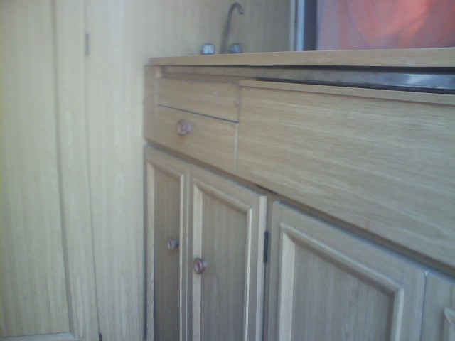

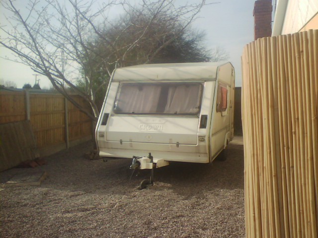

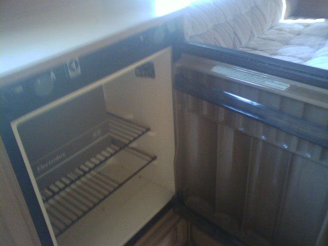

Postby Dewi » Mon Mar 16, 2009 11:55 am

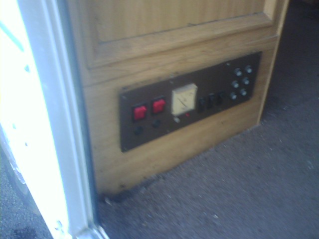

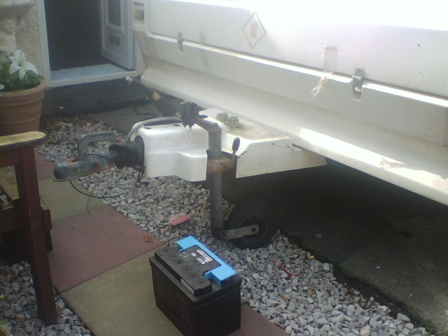

Appears my luck may have changed a little... please welcome one donor...
It's got jacks and towbar (with safety line) and a newish battery...
The inside is kitted out with a shower, fridge, cooker, hob, all the electrical gizmos and presumably a water tank...
Little bit of dismantling and cleaning up to do, but it has a glavanised chassis, which I'm presuming is a good thing. Spare wheel with it as well.
Pleased as punch as I have all the timber and tools I need, just a few fixings left to find and get this design looking something like and I'm on my way.... might just make the Buxton Meet! :D
Cheers, Dewi

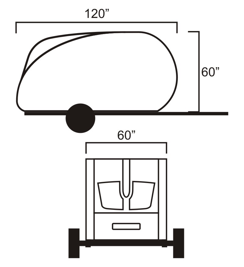

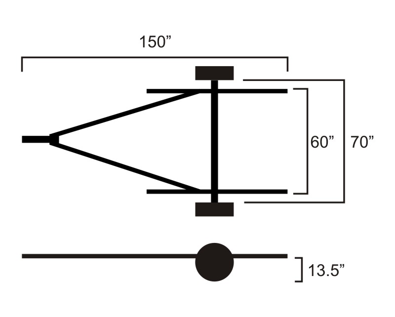

Postby Dewi » Sat Mar 21, 2009 6:03 am
After much head scratching, reading and asking you all questions, I think I've nailed the design... or at least the basic design. I've mithered poor Dave (JackDaw) about the chassis... got it all measured up and checked it can carry what I'm building (fingers crossed) so this is it. I'm not attaching the TD to the chassis until I can balance it, so the final position may be a little different to the pictures...
This is the chassis... measured it as best I could (couldn't squeeze under the donor) and there is no chance of a removable tongue, but I'm leaving boxes around my kitchen floor at home to get used to stepping over stuff whilst cooking :lol:
It's a standard teardrop shape, but with inspiration from Dave, the back has a 4ft wide raised roof to allow for my cunning plan. The back elevation has a split door and a drop down step. I may still add a side door yet, but the weird shape thing on the back elevation is the window and I started designing a decal to ride up over the roof... thats there for position at the minute. The galley area is still at the front, but I've got to plan that out to what I have as I now have a gas/electric fridge, a sink, a hob and a grill, not to mention ready made cupboards and worktops (the donor is kind to me) :)
Not decided on mudguards yet, but I'd like to build some fancy ones that swoop down towards the back.
The interior, through the back door will be a seating area (diner) which will form a 6ft 6" bed, and I'm hoping to squeeze in a lightweight bunk at the front if there's room. the storage will be underneath the seating and for the bed to work there will be runners along the seats and a pull out webbed slat arrangement that will make up the centre of the bed... I'll draw some piccies later on. The cushions for the seating will be made to form the matress for the bed.
Hoping to skin it in composite aluminium (rubbery plastic sandwiched between two sheets of aluminium - very lightweight and already finished with a powder coating) and the front hatch and top of the back door will be attached with hurricane hinges. I'd like some retro style lights, and overall I'd like it to look a little like a 1930's car style (if that makes sense). Once it's skinned, I'm going to vinyl wrap it with a design which if I get bored with it, I'll remove and apply a new one.
That's just about as far as I've gotten... still lots more to plan, but I've got the garage to clear so I can start the build. Once its clear, the donor will be stripped down, salvaging all the bits I want to reuse... the rest will be given a proper burial. :lol:
I know it might be a bit much for a first build, but thats why I'm taking so long planning it... I want to make sure I can actually build with my hands what my mind believes is possible... I should soon find out.
