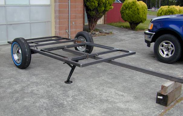

To give a better example of the "how many and where question" it may be more instructive to actually look at Dean's frame.
Your past experience with tripods would not serve Dean or anyone else building a 11 ft. plus teardrop since the doorway is outside the enclosed tripod lines.

Guy wrote:Your past experience with tripods would not serve Dean or anyone else building a 11 ft. plus teardrop since the doorway is outside the enclosed tripod lines.
That's why I will be using a jack/stabilizer at each of the corners. With my larger chassis/cabin, I'm afraid that the door area would have weight and stress on it as you stated, "outside the enclosed tripod lines". The extra weight there may be neglible, but I've said it before and I'll say it again...I'd rather be safe than sorry even if it costs more...and it usually does.

Postby Chris C » Wed Jul 27, 2005 2:46 pm
Guy, you have me confused. :? If I put a Bal jack at the back two corners (underneath the galley end) and use the tongue jack as the third leg, what does the door have to do with the tripod arrangement? :thinking: Is there any reason those three "legs" wouldn't be able to support/stabilize/level/jack up the tear?

Postby Guy » Wed Jul 27, 2005 3:07 pm
Dear Chris,
Think about standing on your doorway to clean the roof of your tear and the leverage your body weight would have. The fulcrum would actually be on a line drawn from ONE rear end jack to the tongue jack. So it would not matter one bit that you had a tripod since you are outside tripod.
Depending on the length, width, weight, and tongue your body weight could cause the tear to tip or be less than stable for the time you were standing on the door sill.

Postby Chris C » Wed Jul 27, 2005 4:29 pm
Okay! I finally got your point. 8) A point well taken too! Thanks for the tip. I'll put it in my tip file.........and believe me, I have one. So-o-o-o............what you are saying is I need some sort of stabilization at all four corners. :thinking: Don't remember seeing any trailers at Minden with that many, but your point makes sense. Thanks for your patience in getting it across to me. I'm slow, but I'm old, so I have an excuse. :lol:

Postby R Keller » Wed Jul 27, 2005 6:28 pm
Guy wrote:Depending on the length, width, weight, and tongue your body weight could cause the tear to tip or be less than stable for the time you were standing on the door sill.
Not an issue. Tripod is fine.
To use your fulcrum example and a back-of-the-envelope simplified calculation: assume a 1,000 lb. trailer is supported by just the tongue jack and two rear jacks with the wheels are totally off the ground, and a 200 lb. person is standing on the door sill (probably at most 1.5 feet outside of the "fulcrum" line).
There is probably, at most, 20% of the total trailer weight (200 lbs.) on the person side of the "fulcrum line", at an average distance of 1.5 feet or less from the line. The person and trailer weight add up to 600 ft-lbs. of torque.
To balance that out, you've got the remaining 80% of the trailer weight (say 800 lbs.) on the other side of the fulcrum at an average distance of 3 feet or more = 2,400 ft. lbs.
600 ft.-lbs. vs. 2,400 ft.-lbs. is no contest. Get six 200 lb. friends on the doorsill with you and you might have a chance at tipping it though!

Postby Guy » Wed Jul 27, 2005 6:56 pm
Good Calcs, Rik.
Given that then the BAL Leveller (Wheel type) and no further stabilizers would be the easiest since the wheel is even closer towards the door?

Dean already made his choice
Postby Guy » Thu Jul 28, 2005 7:10 am
Dear Juneaudave and Rik,
Dean had already made his choice, as the picture I posted above shows. He chose a BAL jack just forward of his door. HEHEHE
