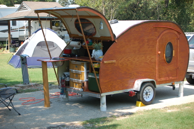

I used some PVC pipe and purchased some of the little PVC caps that fit in them for incremental height adjustments (The PVC was later painted to match the teardrop trim.)
...OR you could use a PVC pipe that is of a smaller diameter w/holes on the side vertically. A small rod could be slide through the holes to decrease or increase the height.
