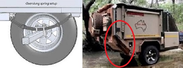

Andrew Herrick wrote:Obviously, there is no one-size-fits-all-answer to ground clearance...- rougher the roads
..... the more ground clearance you'll need.....
This thread seems more concerned with lower, level, and ease of entry; though not stated as such, another clearance issue should address a "minimum angle of approach & departure" for trailers, too. Though mostly of concern to off-roaders, anyone who has scraped a bumper going in or out of a driveway or crossing a large dip in the road has experience with those clearance issues. One poster said he set his overall minimum frame height at 21", for some off-roading. I also have a 21" frame height, soon to be 22"(taller tires), and I did intend to have it this tall, from the start. I did't have the budget (at the time), to buy an axle/spring/tire combination suitable for eventual off-roading, but all my initial designs were headed for that end. The base frame set-up was an 8" tired, motorcycle trailer, that I extended to a 4x8 size, and added 14" wheels (& stronger spindles, bearings, 5-lug hubs) to raise it up higher (+ the advantages of better tires). Longer rear shackles were also included, to help. I set this height for 1) good entry height for me (a little more difficult for the wife), and 2) the aforementioned "approach & departure" angles. While not extreme, they were adequate for what I intended to use the trailer for; more radical angles are used in extreme trails/rock crawler off-road trailers (you've seen the designs: up high in the air, axles with overslung springs, with the rear of the trailer angled up (cutaway).
overslung axle.jpg (50.23 KiB) Viewed 518 times
(I didn't see the need to do this, nor did I want to lose the storage space). If I had stayed with smaller wheels (not 8", that's far too small IMHO), and with the original frame height (about 11-12", I think), I would scrape the bottom of my trailer entering or exiting my driveway (the dovetail on my carhauler always does). I've had bad experiences enough with bad roads, interstate and secondary, much less with rutted fireroads or whoop-de-doos (a term for rapidly changing road inclines and declines) off-road. When I went with my wife to purchase her "business-only" trailer (for "catastrophy" insurance adjusting work), I pointed out that she might not travel the best roads out there; we bought a trailer with high ground clearance, opposed to one of her co-adjusters, who had a low-clearance trailer (got stuck at times).I guess the choice of how high you want your ground clearance depends on what you want to do with your trailer, and where you intend to take it.
