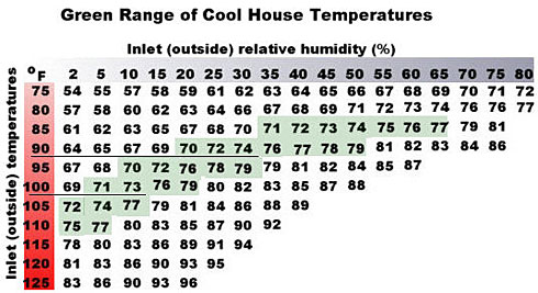

Swamp cooler chart, temperature drop with outdoor temperature and humidity level.

Re:
Postby bdosborn » Sun Feb 23, 2014 4:53 pm
bdosborn wrote:The fans suck air out of the box. That pulls air into the box through the pads. Here's where the swamp coolers work best.
A and B are good regions. C is not so good. I'm in the A region. I wouldn't bother with it if you're in a C region.
