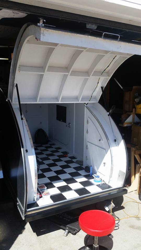

Used the calculator last weekend for my hatch. It worked perfectly. . 31 inch 80 lbs struts that I bought on Ebay. your measurements were perfect. only took 10 min to install them. look for strut-your-stuff-here on Ebay. they have all kinds of strut lengths and weights and hundreds of different brackets picked up everything that I needed for $70.

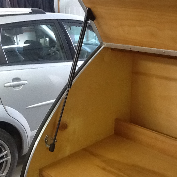

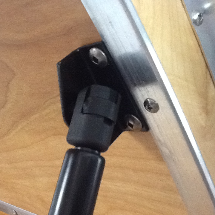

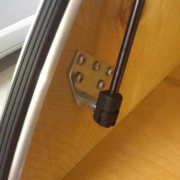

Postby Thommyknocker » Mon Apr 24, 2017 11:02 am
pic for reference, I couldn't pull it of mobile
