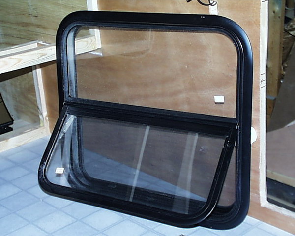

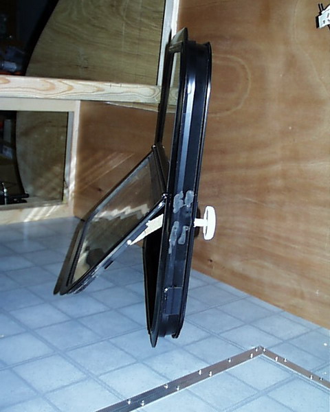

I got two 23" X 25" crank out windows from a guy on E-Bay. I kept bidding on the windows and kept losing out. So I e-mailed him and he agreed to sell me two windows. They are black aluminum with trim ring and the knob for the crank. They have rounded corners. With shipping they were right at $100. I got crank outs because that's what my wife wanted. Does anyone know how you install these things?
